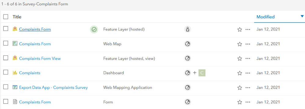

I can not find a help document for this error. This is from a survey on the web and it does not have an error if I open it while signed in to AGOL. But, when anyone else opens it they can not submit a survey. It is a public survey.
The form is shared publicly. When I submit a Complaints Form survey it is added to the Complaints Form feature layer. So, the feature service exists, but it's not shared publicly. How is it not accessible, as the error suggests?

Survey123 leverages this content. It's important that we don't modify it - such as deleting, renaming, or as Keiren suggested changing the editing settings - as this could break the ability of the Survey123 platform to function. We can do some modifications with care. e.g. create new Hosted Feature Layer Views.

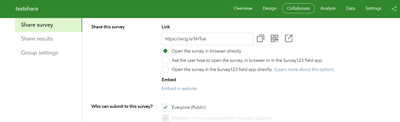

To share access to users we should do so through the Survey123 website:
Which then goes and updates the item sharing in ArcGIS Online:
You'll see the form and fieldworker views are shared publicly, giving access to the questions and ability to submit data.
Your content doesn't appear to match what I would expect to be created from the Survey123 web designer. Have we deleted or renamed content in this folder? Have we been sharing from ArcGIS Online? If so I'd recommend sharing access through the collaborate tab on the Survey123 website.

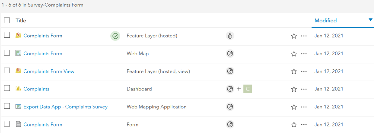

Have you looked at your permissions or the permission settings for the hosted layer?
Do you have a picture of the Portal items?

I did happen to forget to share publicly on the Collaborate page of the survey. But, after setting that to public I still get the error. I don't want this hosted feature layer to be public, and I have view for it. I swear I've had no problems doing this workflow before.

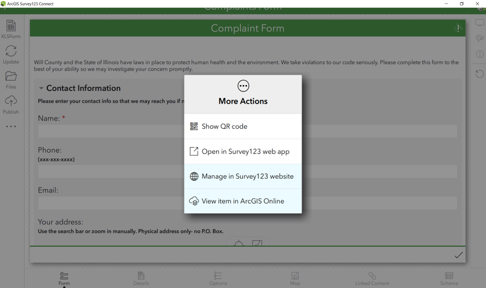

No clue what happened there. I accessed the Survey123 website through the link in the Survey123 Connect app and under Collaborate it was set to organization still. So, I set it to public and now the error is gone. Funny, I already had it set to public, as I said. I access the Survey123 website from a bookmark on my toolbar in FireFox, so maybe it was a browser/cookies issue.

I didn't think I'd be reporting back so soon. But, when I opened a survey today I got the error again. Out of the blue, the share box on the Collaborate page of the Survey 123 website was magically unchecked. So, I clicked the box to share publicly again and it's fine. Is this a bug?

Try going to the Survey123 webpage under Collaborate and check the box for Who can submit to this survey? Sometimes that box gets reset when you make changes to survey.
