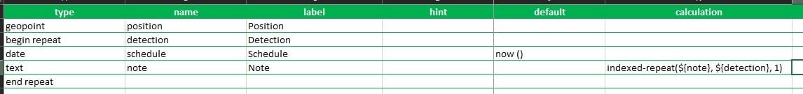

Hello everyone,
I can't seem to create a Survey where the repeat values are prepopulated with the same values as the last record inserted in the repeat (I'm also using the Inbox option).
Let me explain:
I have a form with a geopoint and a repeat that contains two values: date and note
Geopoint
Repeat
-date
-note
end repeat
The surveyor has to find the nearest point to him (use Inbox) and has to insert a new repeat record with the date calculated automatically (I know how to do it) and a new note whose value must not be empty but must be prepopulated by the value of the previous note (I don't know how to do it).

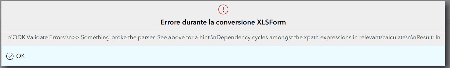

I tried using the indexed-repeat () function but I get a cyclic error.
Do you have any suggestions?
Thank you in advance for your attention,
Paolo

I have been working on this for over 3 years now and have posted on this a bunch of times.  The way you posted will never work as it is a loop.  When 123 displays a page each element has a name so you can't just say give Field A the value of Field A.  I was really hoping when indexed-repeat came out it was smart enough to handle this but no.  indexed-repeat above you can get the value in a different field but not the same field.
The only one I got to work was with javascript.  For me my repeat is too big and so this crashed the tablet.  But it may work for you.
