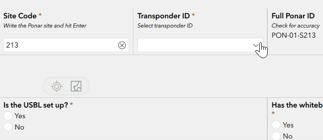

Hello! I've gotten this function working for text and integer type questions (it's been a lifesaver), but encounter a glitch when I try to use it on select_one questions. Here is a screenshot of my xlsx setup:
Row 36 shows the select_one type question. Although the integer and text questions work correctly (rows 33 and 34), this is what I see when I attempt to select a transponder:
You can see that, after clicking several times, the drop-down will appear very quickly, then disappear. Has anyone else encountered this, or am I trying to use the function incorrectly here? Thank you!
BrookeHehr
I am also experiencing this issue! Doug posted it here:
