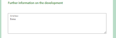

AndyBates
As long as appearance column is set to "multiline" using concat with "\n" works ok for me. ie  concat(${initials}, "\n", ${surname )
