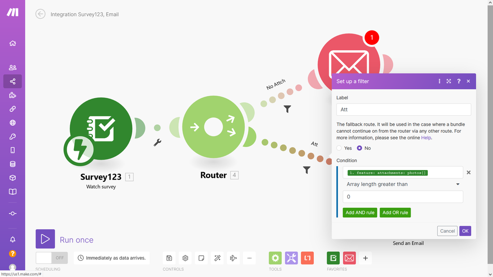

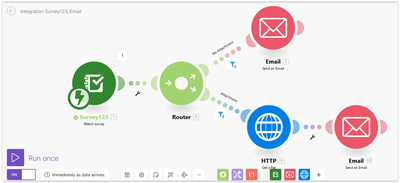

First, here is a screenshot of my scenario:

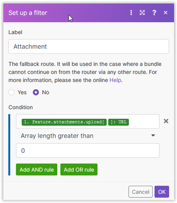

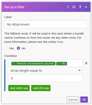

And for my filters, I have the following:
and
However, it doesn't run and the log says: The bundle did not pass through the filter.
Obviously, I have not setup my filter correctly.
Any tips would be greatly appreciated.
