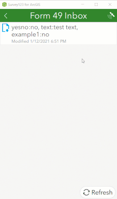

In a survey form, I have a photo field that is hidden unless the field preceding it is set to 'no'. When completing the form for a new feature, then the logic is sound, no issues encountered but when I use the Inbox to edit an existing feature, then the below behaviour is encountered:
I would expect that one would not be able to edit a photo field in the form from an existing feature but when the yes/no question is toggled, then the photo/folder button do show and I am able to capture and successfully send the captured image.
Is this a bug or is there something else causing this?
Some insights would be appreciated.

Ah I see, I must have read your question too fast (sorry about  that). You can’t download attachments from the inbox, but you can upload attachments from the inbox, so I think what’s happening is that when the record is first opened from the inbox, the photo question appears blank since the attachment hasn’t been downloaded from the feature layer. When you toggle from no to yes, the contents of the photo question are cleared because of the relevant, which is why the upload/capture icons become visible.
