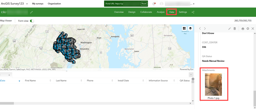

@HarroldLikens1 can you explain how you got this working online? If I view a record via the S123 website 'data' page I can see the photo, eg: https://survey123.arcgis.com/surveys/9xxxxxxxxxxxxxxxxd/data

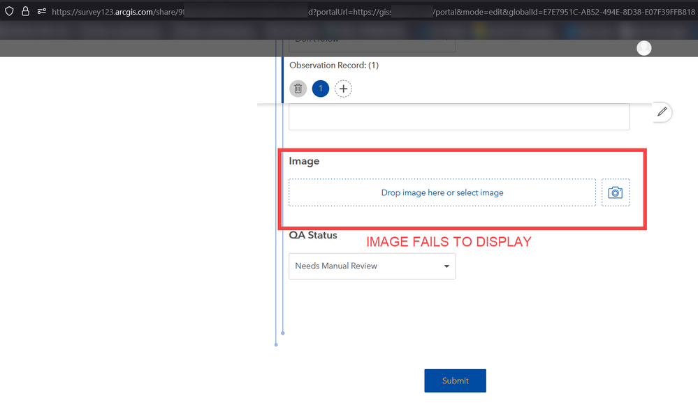

However, if i attempt to view that same record through the inbox, via a URL in a browser it fails to display the image, eg: https://survey123.arcgis.com/share/9xxxxxxxxxxxxxxxxxd?portalUrl=https://gis.xx.org/portal&mode=view...
