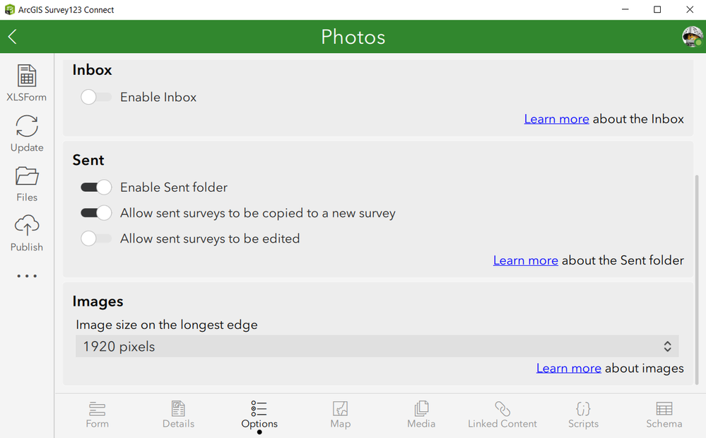

Using Survey123 Connect, you can control the size of photos sent to ArcGIS. There are a number of devices out there and each of them may send photos of different sizes. You can bring consistency by properly configuring your survey from Survey123 Connect.
In Survey123 Connect, go to the Options tab of your survey and scroll down until you see the Images section. Use that setting to control how big you want images to be when sent to ArcGIS. The default value is 1280 pixels on the largest edge, which generally works well for most workflows, the quality is good and the size of the photo is manageable.  However, you can reduce images down to 320 pixels or leave them in their original size.
The Survey123 Connect setting above applies to all image questions in your form, unless you overwrite this value with the max-pixels parameter. As you can likely already tell, the max-pixels parameter controls the image size on the longest edge at the question level.
