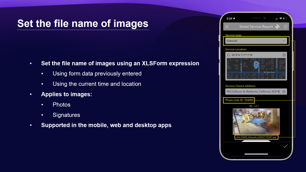

Look at the screenshot below. Note how the file name of the photo has been automatically set to combine previously entered information: The Job ID and Service Type.

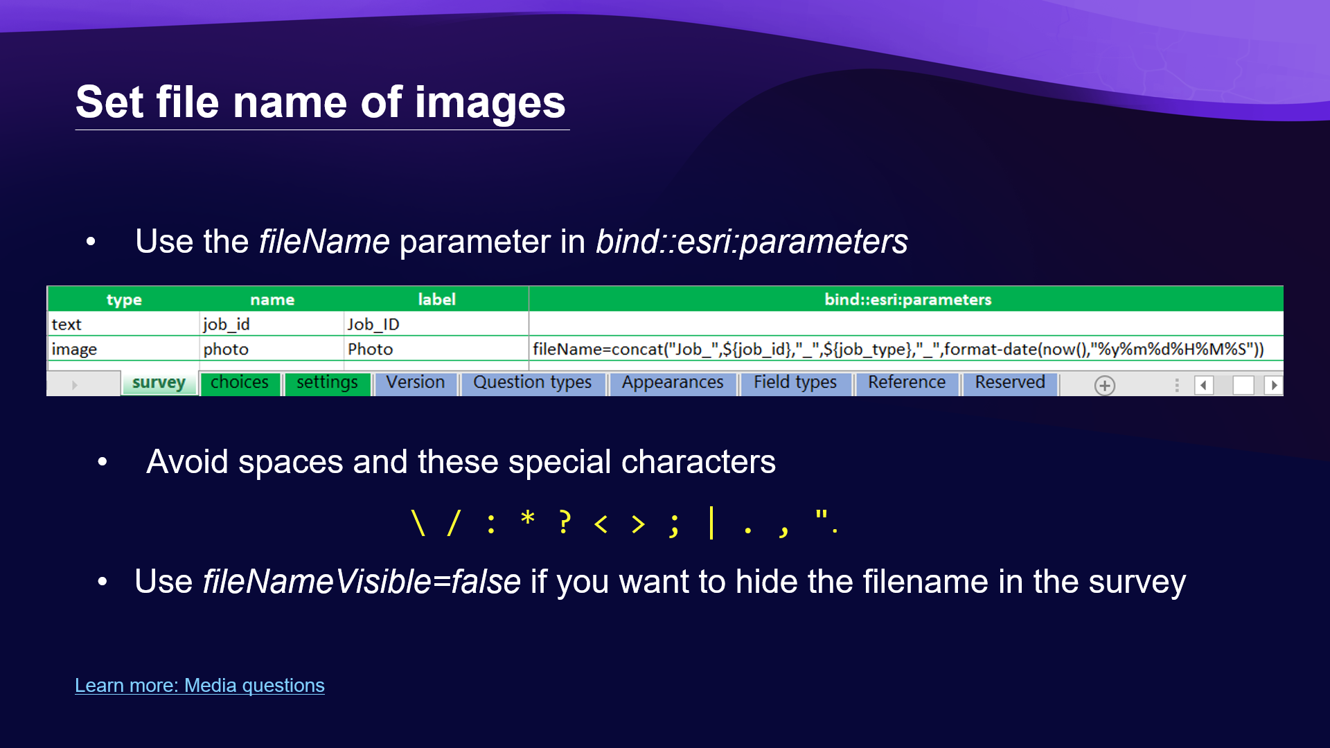

To control the name of the files you upload from Survey123 into ArcGIS, you need to use the fileName parameter in the bind::esri:parameters column, as shown below.
Here are some examples:
The name of a photo combines the job ID, type and the current time.
The name given to the signature image file combines the inspector full name with the current time.
