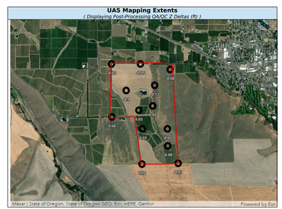

Good Morning,
Is it possible to change the appearance of geoshape polygons in the Survey123 feature report yet?  I have a feature report that shows mapping extents on a web map with an underlying dataset that contains symbols and labels and the default fill color of the polygon in the rendered map obscures the other symbiology.

Say what now?
I *want* the symbology of the other (point) feature layer in there.  That's supposed to be displayed.
The stroke & fill appearance of the polygon from the geoshape question in the XLS is what I'm trying to change in the feature report. How do I change the appearance of that polygon in the feature report?

The web map I am using only has a feature layer with points in it (the checkboard pattern. EDIT: Sorry, the black circles. I forgot what screenshot I had used).   There is no polygon layer in the web map. The displayed polygon is just the geoshape from the S123 form and that's how it's displayed when the map renders (even if you just use ${geoshape} in the feature report, without specifying a web map ID).

It looks like changing the polygon appearance in the "visualization" page of the survey's feature layer is what affects the appearance of the polygon.
