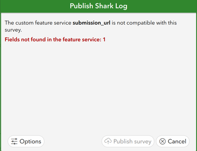

I created a survey form from my feature service. I went to add a field in the XLSForm and it will not publish because of the error in the picture below:
I have not done anything to the original feature service and have not moved any of my files into different folders since the beginning. One day it just wasn't working anymore. I don't want to have to redo this survey since its linked to my WebApp so I hope there's an answer!
Thank you!
by Anonymous User
Not applicable
If the hosted feature layer was created as part of the survey publish process, the same warning would appear but you would have the option to add the missing field.
This survey uses a custom service URL, meaning we targeted an existing feature service instead of creating one as part of the initial publishing process. As Survey123 didn't create or 'own' the hosted feature service on creation, you will need to ensure the target service URL has the necessary fields for the questions in your survey.
In short you'll need to add a field to your feature service manually, as it is a custom service URL.
Cheers, Chris
