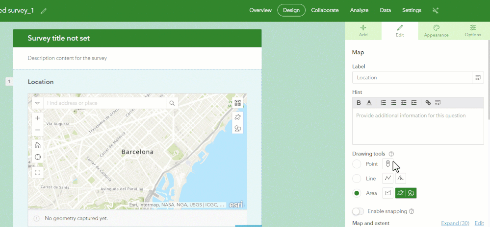

Can the Survey123 map question be configured to collect lines or polygons? Yes, as shown in the animation below, the web designer lets you decide what type of drawing tools you want to make available to respondents.
Please note that once you publish your survey, you will NOT be able to change the type of drawing tools in the map question.  This is because publishing a survey creates an ArcGIS layer and changinf the geometry type on the layer is not possible.

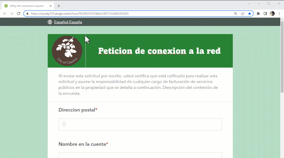

How can the end user change the language of a form? If you translate your survey, a new language menu will be added in the top navigation bar. Users can change the language of the survey using that menu at any time.

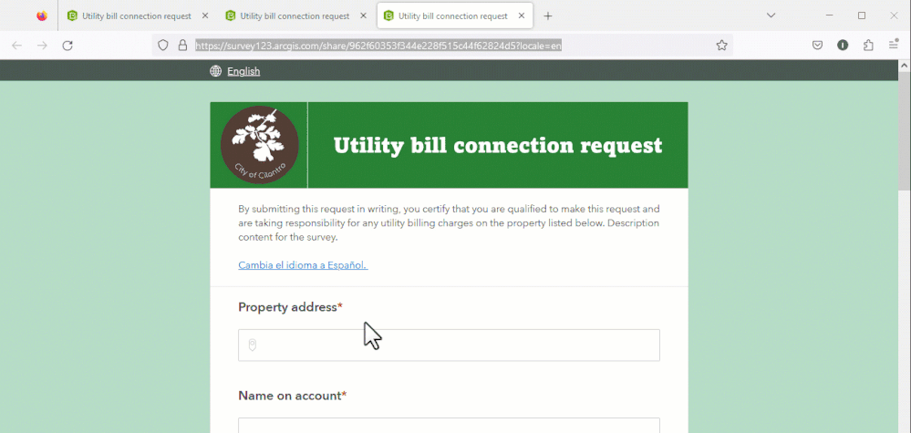

Additionally, you can insert links throughout your survey to make the language switch more obvious, as shown in the animation below:
To construct the survey link, all you need to do is to add the locale parameter at the end of the survey url. For example: https://survey123.arcgis.com/share/<itemID>?locale=en (for English) or https://survey123.arcgis.com/share/<itemID>?locale=es (for Spanish)
One more thing: If the survey link does not include the locale parameter, Survey123 will always try to change the display language of the survey, if available, to one that matches your operating system language.

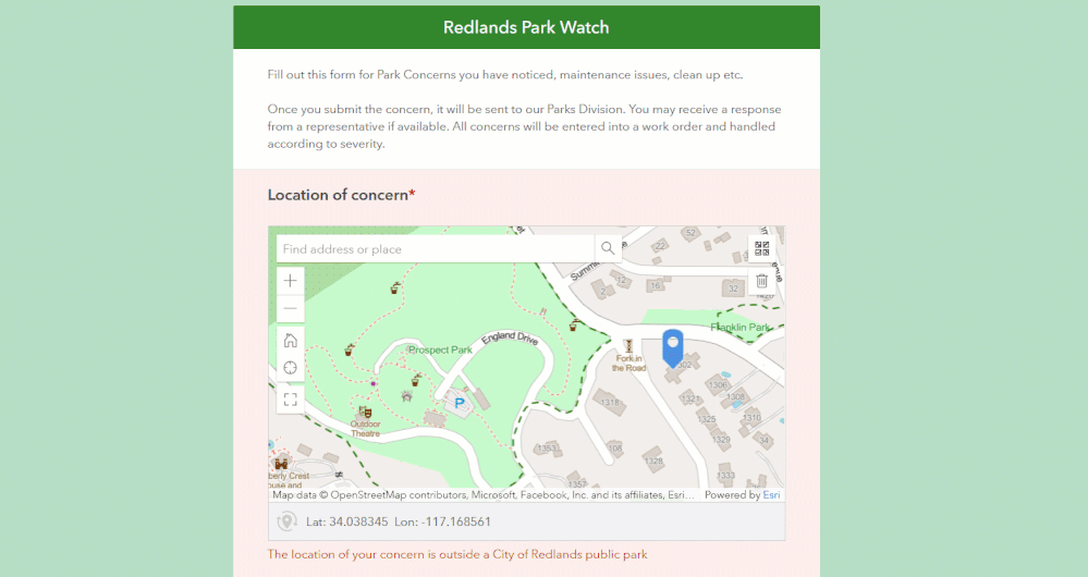

Can I configure a data validation rule in my form to ensure that locations are only added within my own area of interest? For example, say I want people to only report incidents within the boundaries of my city.
It is not possible if building your form using the web designer, although we are considering this as a future enhancement. At this time, you will need to author your form in Survey123 Connect if you want to create such a validation rule.  I am including below an animation that illustrates what this type of rule could look like. In this case, I am using the Public Parks polygon layer to feed the validation rule. If the pushpin is placed outside a park, then the map question triggers the warning.
Check this blog to learn more about how to configure these type of rules using Survey123 Connect.
