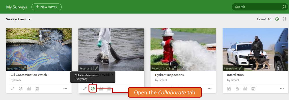

  • Sign in to the Survey123 website at survey123.arcgis.com.
  • From the survey gallery, open the Collaborate tab of your survey

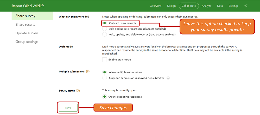

  • Scroll down the page and look for the What can submitters do? section. Note that by default, the selected option is 'Only add new records'. This guarantees that your survey layer will not expose your survey results.
  • Click on Save at the bottom to persist all changes.
