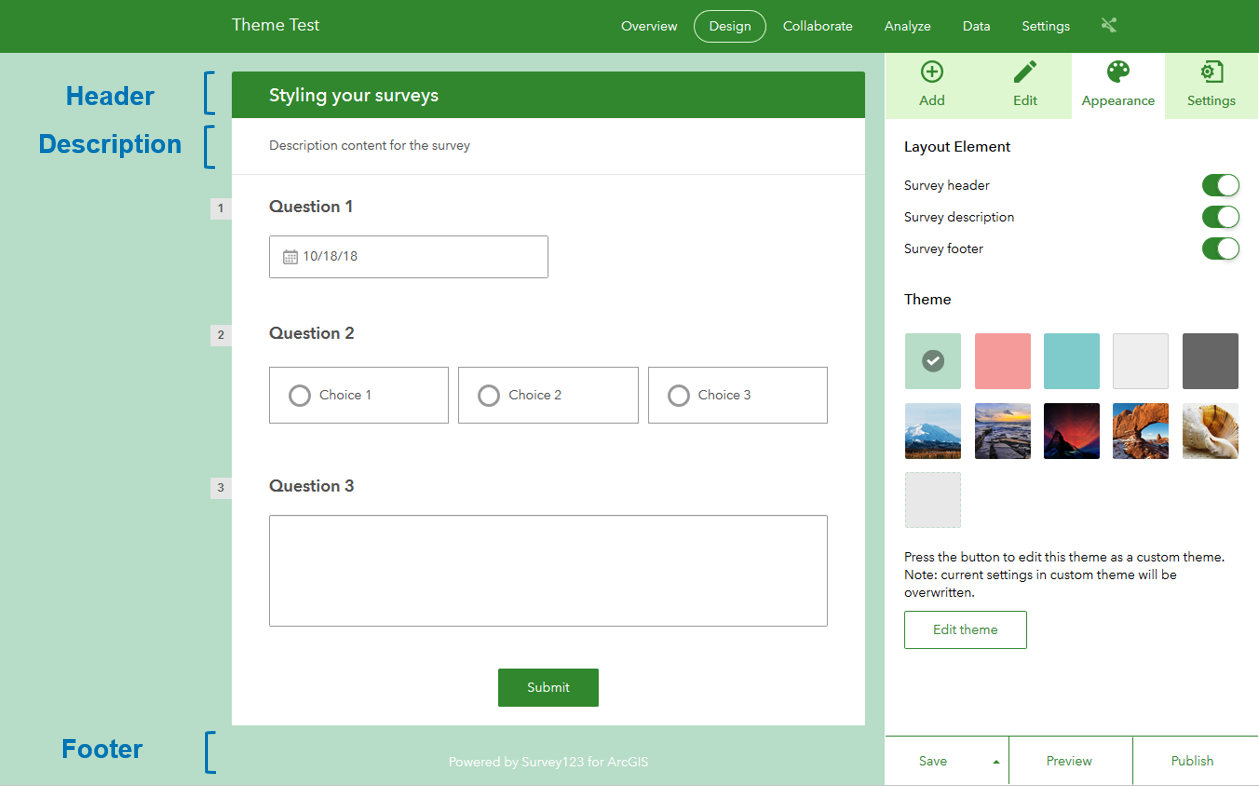

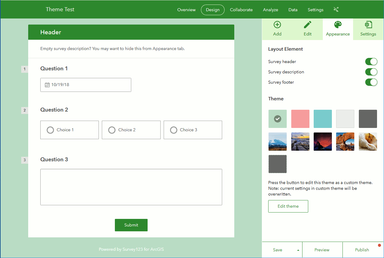

Basic Layout Elements: Header, Description and Footer
The basic elements around questions in your survey are the Header, Description and Footer.  Right from the Appearance tab, you can choose to show them, or hide them. For example, the Description element is typically used to describe what your survey is all about.  It is generally made out of text or a combination of text and images. If you feel like the title shown in your header is descriptive enough, you can choose to hide the Description element all together.
By simply clicking on the Header, Description and Footer in the design preview, their properties will be made editable in the right panel of Web Designer.

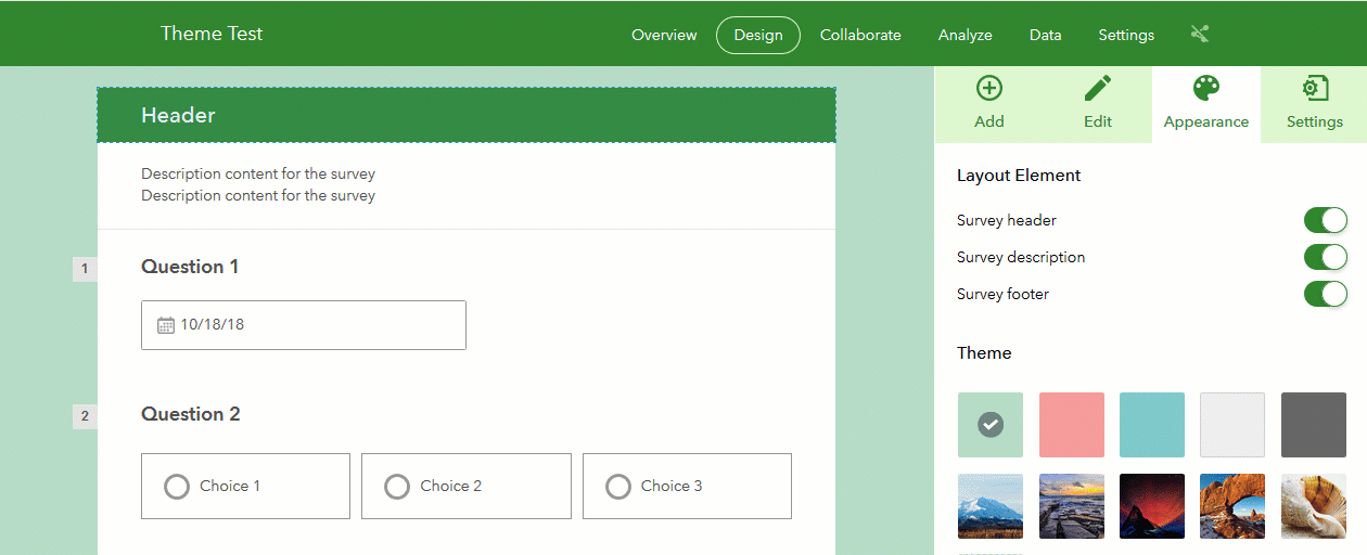

Survey Header
The header typically holds the title of your survey, but it is also a great location to display an organization logo.  You can choose a Text Header, for which you can control its background color and text alignment, or an Image Header.
If you choose an Image Header, your image will be adjusted so it fits the entire width of the survey, which will not be larger than 680 pixels. For this reason, as a general rule, your header images should not be wider than 680 pixels. The height will be set so your image aspect ratio is preserved. It is best to go with a wide image to avoid taking too much vertical space.  The header is taking the top most part of the display, so with such prime real estate on your screen, you do not need a big, tall header to make a point.
When selecting an image for your header, you can either reference an existing image through a URL or upload a new image. I either case, try use lightweight images or otherwise your survey will be slower to load.

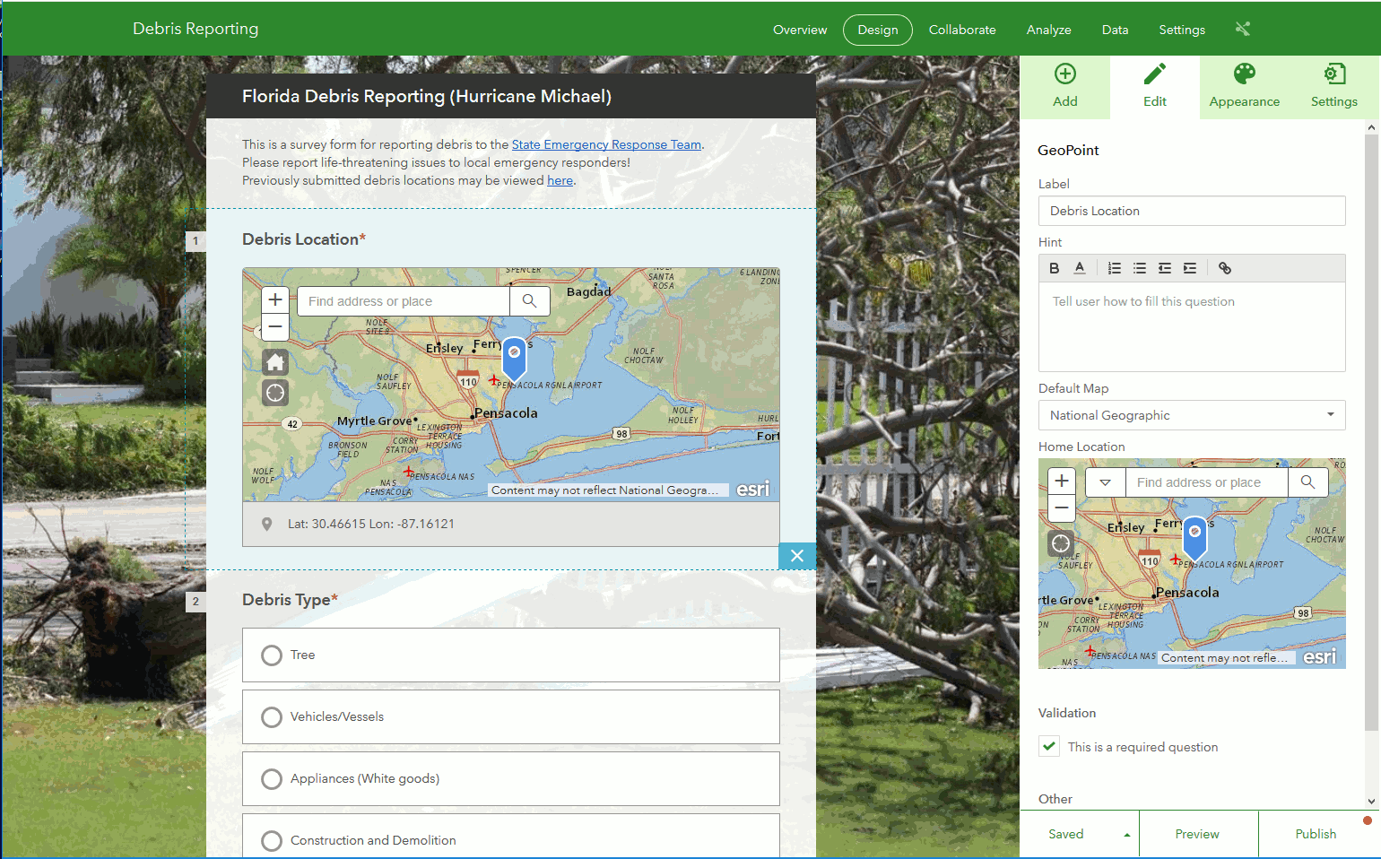

Survey Description
The Survey Description element, in Survey123 jargon, is a Note question type. Just like with the Survey Header, you can easily hide the Survey Description element from the Appearance tab.  To set the content of the Description, simply click on the element in the preview, and all the settings will appear in the right panel.
Note that the contents of the Description element accept rich text, so you can add entire paragraphs controlling the font color, size, text alignment, images, links, etc. This makes the Description very flexible, allowing you to provide context about the survey itself.

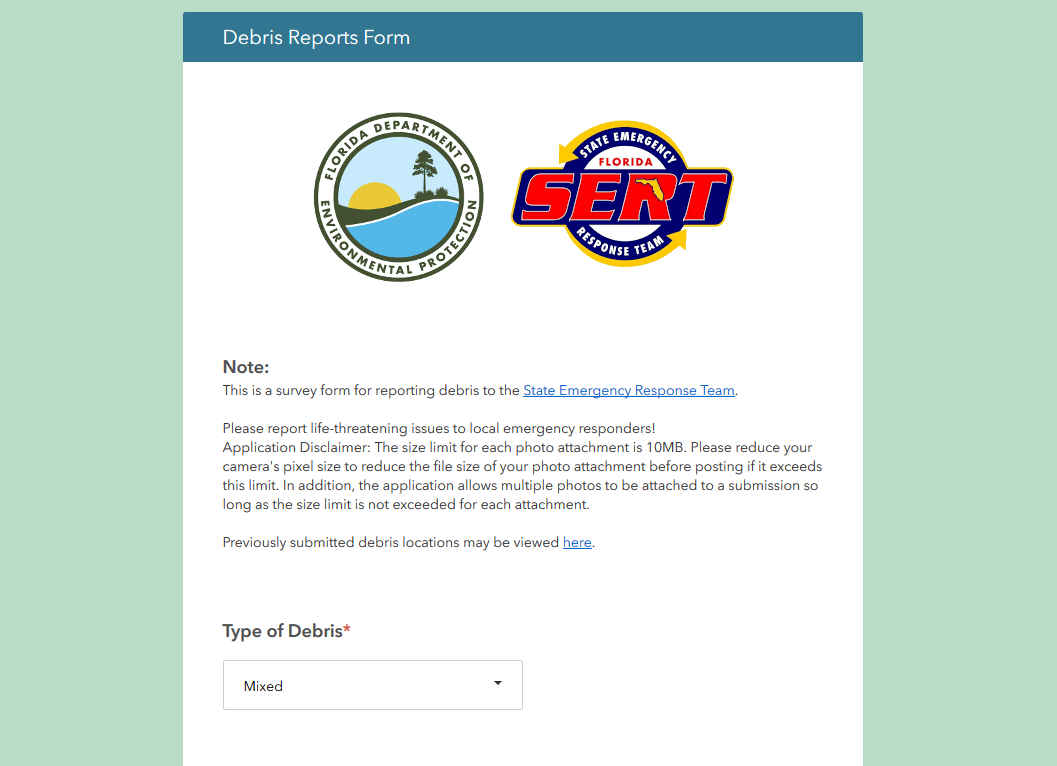

To support recovery effort after hurricane Michael, the Florida Department of Environmental Protection and the Florida State Emergency Response Team, published a public survey to help citizens report the location of debris.  Note how they used the Survey Header to include a simple form title, and then leveraged the Survey Description element to place their organization logos as well as a brief note about the purpose of the survey. The Survey Description element also included links referencing the organizations website and other relevant documents.
The Survey Description element is particularly critical for public web surveys where you cannot assume that people know what your survey is all about. A bit of context, is always good!

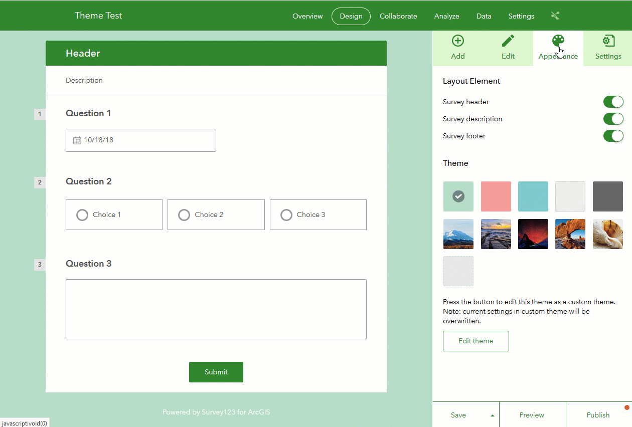

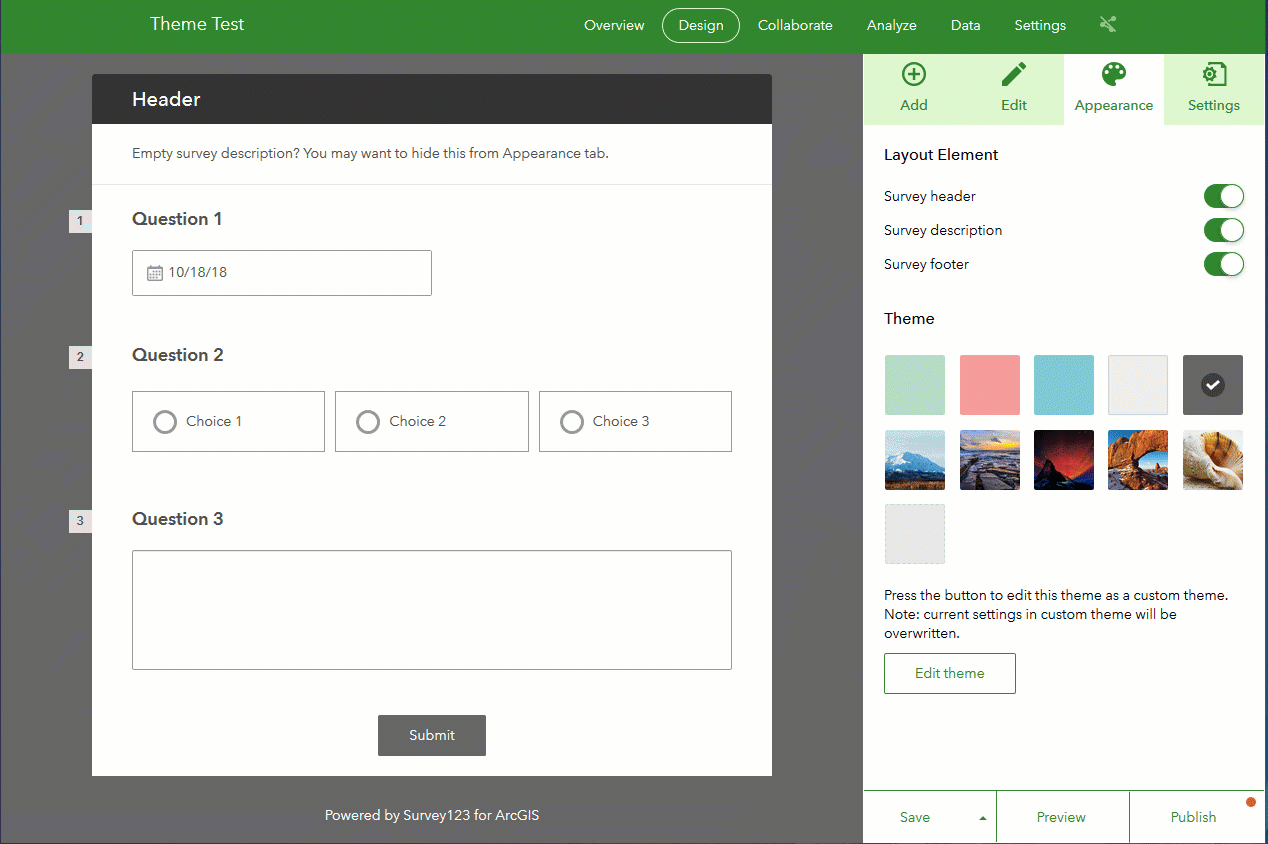

Survey Themes
Survey Themes help you easily define the color scheme of the most relevant visual aspects of your survey. A gallery of basic themes is included with Survey123.  Most themes are based on a primary color applied to the background page of the survey. Different shades of that color are then applied to the header, background of the form and submit button.  The Theme also defines the color assigned to the text in your form, so it contrasts over the background. A second group of default themes uses a background image as the driver for all the visual components in the form.  You can use the themes included as they are. We added a good set of them and you can switch and see how they play out with your own surveys very quickly.
You can also use the included Survey Themes as a starting point to your own design.  That is, you can select a basic theme and then edit it.  The editable properties of a Theme are split as follows:

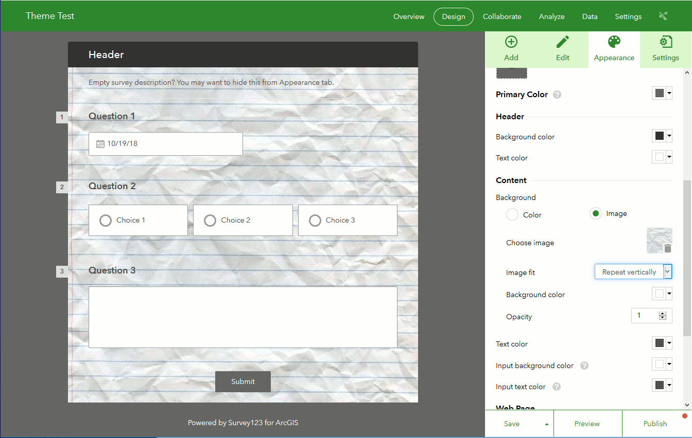

Content Background: The content background sits right underneath your survey questions and should not be confused with the page background, which I will describe later. The purpose of the Content Background is to ensure that all questions in your survey are legible. You will want a nice contrast between your questions and the content background: A light background goes with dark question text and inputs, and vice versa. In the vast majority of cases, you will want to use a solid color for your Content Background.
If you want to get creative, you can experiment with images for the Content Background as well, but you need to be careful not to overload it with colors, which would only create distractions. When it comes to images for the Background Content, it is best to use lightly textured images.  Below are a couple of examples using images to create a notebook and wrinkled paper feel.
When using content background images, you will want to play with the different Image Fit strategies available (Repeat, Repeat Vertically, Fit and Center).
For both color and image custom content backgrounds, you can adjust the opacity level, which can give you interesting effects when working in combination with the page background.

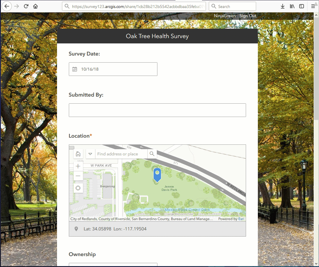

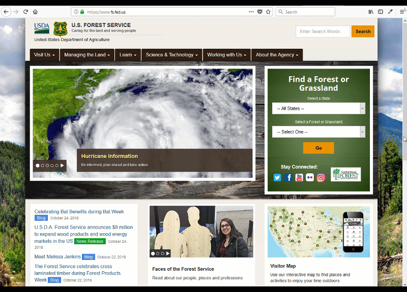

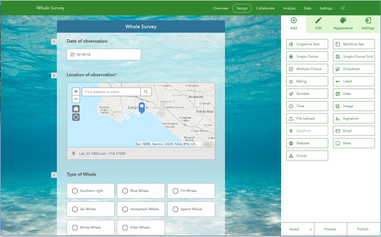

  • Web Page: The Web Page element represents all the background behind your actual form content.  This element is visible in desktops and tablets, but it is mostly hidden in smartphone form factors.  You can manipulate the color and image shown in the Web Page background, allowing you to give a strong look to your smart form. The Web Page background is probably the element that can bring the most character to your design. In the following example, I set a colorful image as the background of the page, for my form to stand up strongly, and to highlight the core mission of the form: trees.
As mentioned above, you can use the opacity setting in the Content Background to create interesting visual effects against the Page Background. The next screenshot shows a medium opacity level applied to the Content Background, to create a subtle translucent effect.
The Web Page Background is only shown by the Survey123 Web App. The Survey123 Field App ignores the background because the from content is always expanded to take advantage of all the real estate of your device.

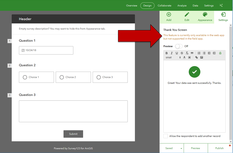

Thank You Screen
The Thank You Screen can be optionally presented in Web Forms right after a survey is submitted.  This is the perfect place for you to thank the survey respondent for taking the time to complete the form, acknowledge the work of your project sponsors or highlight your own organization.
You can include formatted text, links and even custom images within the Thank You Note. I like to give some love to the Thank You Screen in my surveys, particularly when they are public, because they give it a nice touch.
If you look carefully at the bottom of the Thank You Screen dialog, you can optionally enable users to take submit data again with your survey, right after submitting. This option simply adds a link in the Thank You Screen that will quickly take you back to the survey.
