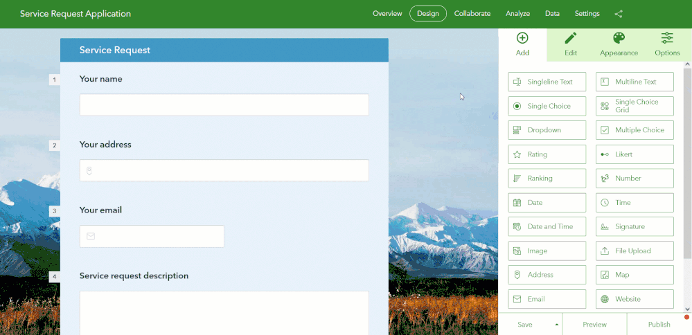

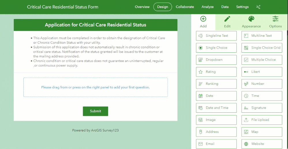

The address question type is available in the Survey123 web designer. To get started, add this question into your survey design as shown in the animation below.
After you set the label of your question and optionally its hint, an important decision to make is what data you want to submit:
  • Address text and point geometry: Stores the address entered by the user as text and it also adds the address location to a map. This option is great if you want to view and analyze survey responses geographically. Storing the location of an address as provided by the ArcGIS World Geocoding service is subject to ArcGIS Online credit consumption as described in the Credits by capability section of the ArcGIS Online help.
  • Address text only: Stores the address entered as text. If you plan to collect multiple addresses in your form, or if you are already collecting a location through a map question, you will want to choose this option.

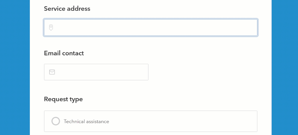

The autocomplete feature of the address question is critical to ensure the best experience for the respondent and the highest quality possible for your data. The smarter you can make the autocomplete behavior, the happier respondents will be and the better data you will get.
Address questions are powered by either the ArcGIS World Geocoding service or your own locator. They both provide a well-known collection of addresses that will be used to support the autocomplete feature in the form.

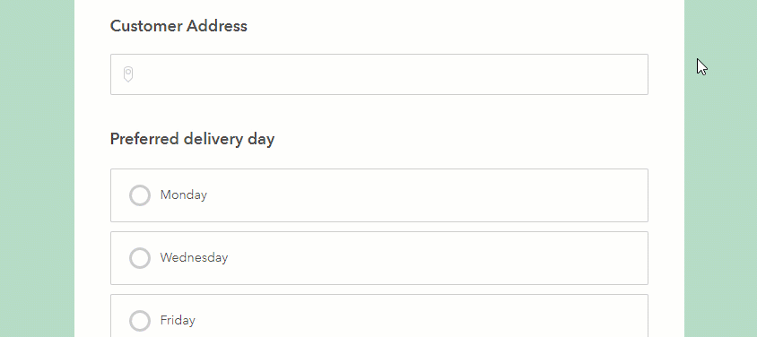

In the animation below, the locator has been configured to find addresses anywhere in the world. Note that as the user starts entering the address, the list of candidates includes addresses from various countries.

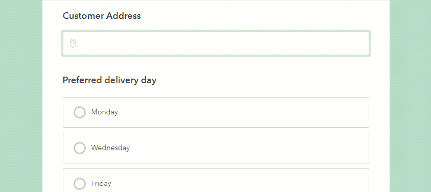

In the next animation, the same address is entered but the list of candidates is restricted to the city of Redlands. This is because the locator is configured to only look for addresses in Redlands, California.
Restricting your locator to limit address candidates within your area of interest is always a good practice. A more accurate list of candidates is a first step toward better quality data.
