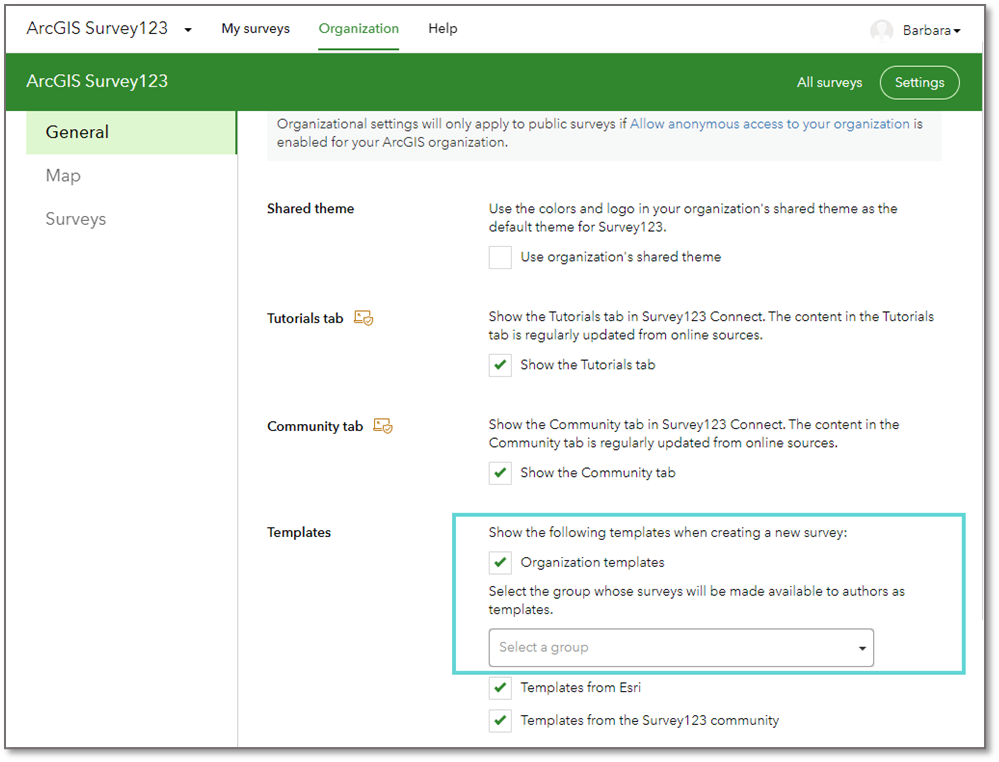

The organization administrator enables organization templates with the following steps:
  1. Create a group that will contain the templates.
  2. In the organization settings in the Survey123 website, enable organization templates and select the template group.
  3. Populate the template group with surveys.

Enable organization templates and select the template group
The options to enable organization templates and select the template group are in the Settings section of the Organization tab of the Survey123 website. Only users that are organization administrators will be able to see the Organization tab.
In Survey123 Connect, these organization settings are updated on sign in, so any changes to these settings will be seen either after restarting Survey123 Connect or after signing out and back in again. In the Survey123 website, changes to organization settings will be seen when the browser is refreshed.

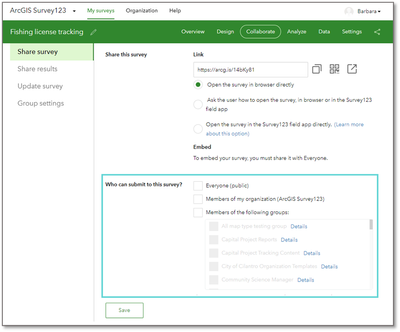

  • Sharing permissions of the form item
    The survey authors will be able to see any template surveys that are shared with them. The form item can be shared with a specific group, the entire organization, or publicly. The images below show the different sharing permissions for a form item, which can be accessed either in the Survey123 website Collaborate tab or in the item’s details page in ArcGIS Online.
    BarbaraWebster1_6-1670032144390.pngBarbaraWebster1_6-1670032144390.pngBarbaraWebster1_7-1670032150898.pngBarbaraWebster1_7-1670032150898.png
    Remember that, as discussed above, the survey authors will also need permission to view the organization template group.
