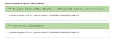

anonymous55
Hello
I shared Analyze page with some users but we can't see some fields?
and shows this.
What is of meaning of this?
I didn't find anything about those dot in green area.
