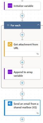

Immediately after your Survey123 trigger, add the Initialize variable action. We will populate this variable later with the attachments from your survey. Make sure you set the Type to Array and set a descriptive name. Leave the initial value empty.
Next, add the Get attachment from URL action from the ArcGIS connector.  This will help you download the attachments. For the URL parameter, you will use the Dynamic content dialog and select the feature attachment URL for your question. In my case, the question with attachments in my survey is called Photos, so the dynamic content is feature attachments photo URL.
As soon as the URL parameter is set, Microsoft Power Automate will wrap the Get attachment from URL action within an Apply to each block. This is because the Photos question in the survey may have one or more attachments in it. Power Automate cycles through the Survey123 attachments using an Apply to each block.
At this moment, we are ready to populate the Array variable we setup initially with the attachments found in our Survey123 Photos question.  This is done through the Append to array variable operation and since it is the most complex part of the entire workflow, so I broke it down into two steps.

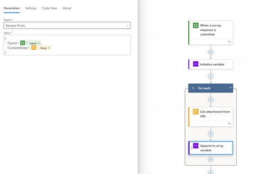

Step 1: First we add the Append to array variable action right after Get attachment from URL, and within the Apply to each block. For the Name parameter, we will select the name of the array variable we want to populate, which is the one we created at the beginning of the flow.  The Value parameter must include a JSON string so we can specify both the name as well as the actual content of the file.
The preliminary JSON string looks like this:
  "Name": <File name including the extension goes here> ,
  "ContentBytes": <File contents go here>

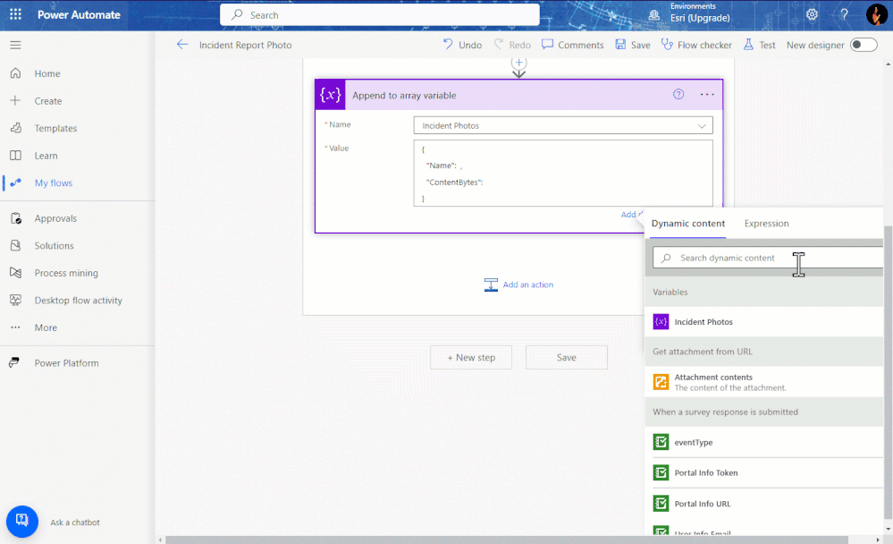

Step 2: To specify the correct file name and contents, we will use Dynamic content. In my case, since the question in the survey with the attachments is called Photos, the name comes from feature attachments photos name. The ContentBytes value in the JSON needs to get populated with the Attachment contents output from the Get attachment from URL action.
With the array populated with all the Survey123 attachments, we can now proceed to configure the Send Email action in Microsoft Power Automate.
Add a new Step to send an email, but make sure it gets added outside the Apply to each block. After completing the Recipient, Subject and Body parameters, expand the Advanced options

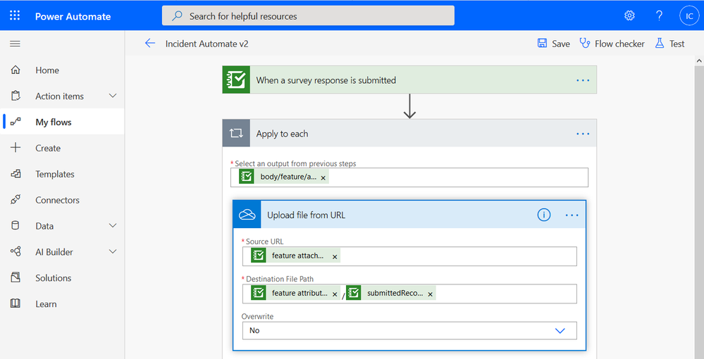

If you want to upload your attachments into Microsoft One Drive, for example, you can use the Upload file from URL action. For the Source URL property, select from the Dynamic content dialog the feature attachments URL array for the appropriate question in your survey. Remember that if working against a private survey you will also need to add your token to the url (?token=[Portal Info Token]).
An apply to each block will be added automatically for you. Now all you need to do is to select the Destination File Path for your file. You can select an existing folder, or even create a new one.
In the example above, I set the Destination File Path using one of the questions in my survey. The value of my question determines the directory in OneDrive where the file will be stored. If the folder exists, it will use it. Otherwise, it will create a new one. This is an interesting concept, as it helps organizing files nicely: by ZIP
code, by case ID, by field team, etc.
A similar approach can be used to upload files into SharePoint as shown in the following screenshot:

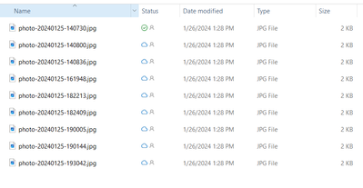

I have jpg files downloading but there is no photo. Its all 2KB files. Do we need to put a token in the photo url for it to download correctly?
Edit:  Adding the token to the URL worked.

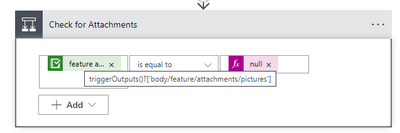

Hello @IsmaelChivite, question about flows where photos are optional. The photo field I am using in the "For each" trigger sometimes does not have a photo. I used the "Run after" setting to bypass this and send out an email regardless of if a photo is included. I am still getting "Flow failed" notifications as a result. Is my approach the best way to do this or should I do a conditional of some sort? I would ideally not like to be notified of a failed flow when the email does successfully send.
Thank you! Please see screenshot example below.

Hi @Tiff
Try setting up using a Condition to check if the variable for the attachments is empty or not, then run the apply to each only if it does have content. If null, just send the email, if not null then run the apply to each.
Tiff
Thank you @RobertAnderson3! What I was missing from this was simply being able to put null down as the function/criteria. I didn't know I could do that. I've tried this and will be able to test it out soon.

No problem @Tiff! Yeah, it needs to be added in under the Expression, it's a function in there. Hopefully it works for you!

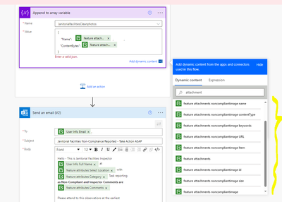

SusanMathai
@IsmaelChivite
Hi Ismael , Please can you identify the invalid JSON error here, regardless of whatever item i choose from the list as shown in the picture below, I get an error "Enter valid json"
I appreciate all your help!
Thanks a lot.
RobertAnderson3
MVP Regular Contributor
@SusanMathai It looks to me like you might have an extra comma in there beside the Name: section?
SusanMathai
@IsmaelChivite
Never mind I fixed the error it works perfect now.

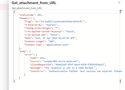

m3
"innerError": "Authentication failed. Your session has expired. Please log in again to continue."
That is my error message
abureaux
MVP Frequent Contributor
I would definitely try refreshing the connection.
  1. Click Connections
  2. If you are using Enterprise, look for the purple ArcGIS Enterprise connector.
    If you are using AGO, look for the orange ArcGIS connector.
  3. Click the ellipses (...)
  4. Click Switch account and log in using an account with appropriate permissions.
After that, try the flow again. Honestly, it should work after this. If it still doesn't work, jumping on a call with Esri Tech Support may be a good next step so they can see exactly what you have configured.
m3
That worked, I had to delete all my cookies to ensure I was switching to the correct account.
Thanks!

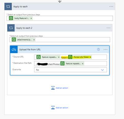

SaadShahzad
I've tried everything to get this method to work, but I cannot get it to work for ArcGIS Enterprise and using attachments in a repeat.
Any tips on how to get this working when attachments are put in a repeat?
abureaux
@SaadShahzadyou need to loop through the repeat. While not working with attachments, I have a guide for working with nested repeats in Power Automate. The concepts are all the same though.
The only thing you will probably need to account for is empty/null attachments. That can be achieved with a "Condition" action.

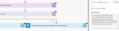

RuchiraWelikala2
We have people submitting multiple PDFs, images, zip files, etc. It worked until about 2 weeks ago but then suddenly started failing. I followed this tutorial by when it comes to sending the email, i receive the following error:
  "status"400,
  "message""No input parameters provided. Please provide required input parameters 'To', 'Subject' and 'Body'.\r\nclientRequestId: a3a4cf18-812c-4f53-a13e-084751xxxxxx",
  "error": {
    "message""No input parameters provided. Please provide required input parameters 'To', 'Subject' and 'Body'."
  "source""office365-wus.azconn-wus-001.p.azurewebsites.net"
Has anyone else experienced something similar lately?
abureaux
@RuchiraWelikala2, have you tried refreshing your Connections yet? I'd guess that they timed out. Beyond that, you may wish to make a post on the S123 forms for more detailed help.
RuchiraWelikala2
@abureaux Yes, I have. I added a trigger event all over again and reconfigured everything but still failed to work. I isolated the issue to just the array and the attachments. I created a brand new workflow using the new designer and the updated modules in the new designer and it is working now. Very strange.
