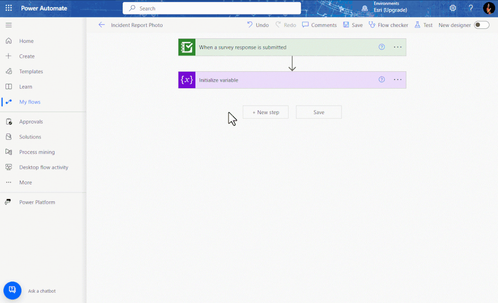

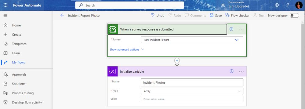

Immediately after your Survey123 trigger, add the Initialize variable action. We will populate this variable later with the attachments from your survey. Make sure you set the Type to Array and set a descriptive name. Leave the initial value empty.

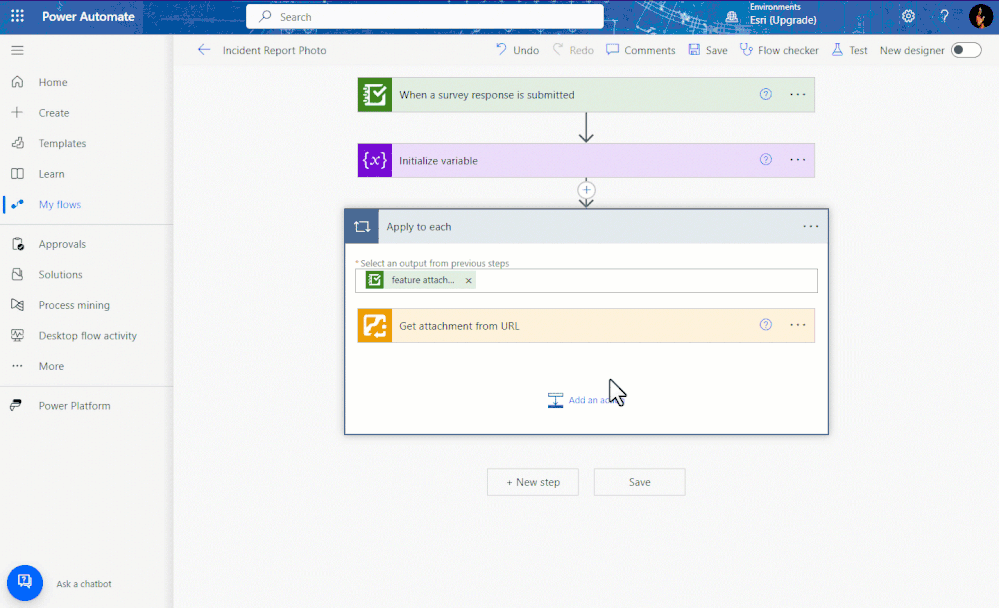

Next, add the Get attachment from URL action from the ArcGIS connector. This will help you download the attachments. For the URL parameter, you will use the Dynamic content dialog and select the feature attachment URL for your question. In my case, the question with attachments in my survey is called Photos, so the dynamic content is feature attachments photo URL.
As soon as the URL parameter is set, Microsoft Power Automate will wrap the Get attachment from URL action within an Apply to each block. This is because the Photos question in the survey may have one or more attachments in it. Power Automate cycles through the Survey123 attachments using an Apply to each block.

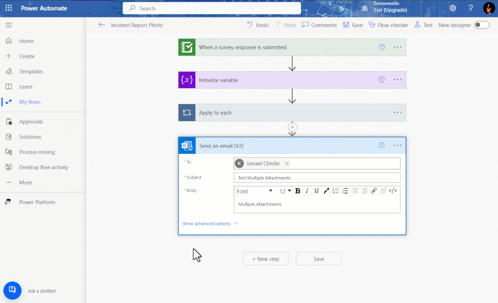

Add a new Step to send an email, but make sure it gets added outside the Apply to each block. After completing the Recipient, Subject and Body parameters, expand the Advanced options.
In the Advanced options you can specify the attachments that should be included in the email. Note that there is a switch button that lets you specify either a single, or multiple attachments. In our case, we want to select the multiple attachment view and then insert the value of the array we populated in there, as shown in the animation below.
Now you are set! Save and test. The workflow described above will work when you have one, but also when you have many attachments.

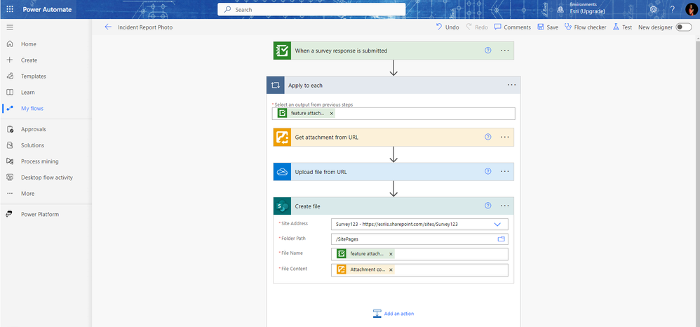

If you want to upload your attachments into Microsoft One Drive, for example, you can use the Upload file from URL action. For the Source URL property, select from the Dynamic content dialog the feature attachments URL array for the appropriate question in your survey. Remember that if working against a private survey you will also need to add your token to the url (?token=[Portal Info Token]).
An apply to each block will be added automatically for you. Now all you need to do is to select the Destination File Path for your file. You can select an existing folder, or even create a new one.
In the example above, I set the Destination File Path using one of the questions in my survey. The value of my question determines the directory in OneDrive where the file will be stored. If the folder exists, it will use it. Otherwise, it will create a new one. This is an interesting concept, as it helps organizing files nicely: by ZIP
code, by case ID, by field team, etc.
A similar approach can be used to upload files into SharePoint as shown in the following screenshot:
