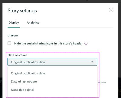

@MargieMassier -- Yes, this is still available in the story settings. However, you now have even more control over how the date appears on your story cover, so it's no longer a checkbox, it's a dropdown menu since there are three options.
If you want to hide the date, just select "None (hide date)."
