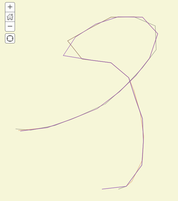

Here is what the three lines look like from a quick walk in the parking lot. Each of the three condition attributes makes its own line (with null values for the other two attributes). It's a bit hard to see but sometimes the lines are on top of each other and other times they aren't.

In terms of having all lines overlapping. As lines start at slightly different times, it takes a few vertices before the lines start to share the same geometry (this is a result of the way the database batches updates). After a while, you should find that the lines will be exactly the same. Please let us know if you are seeing anything different.

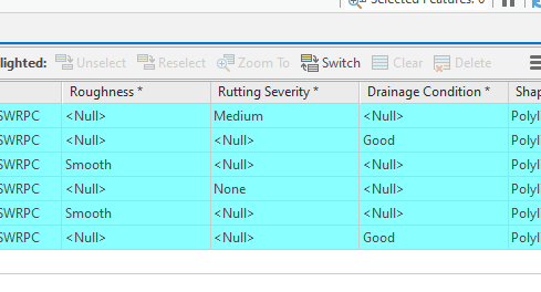

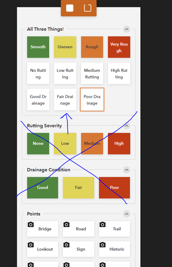

Thanks for your response. I wasn't quite clear in my initial post. The roughness, rutting, and drainage items are in a single line feature (not different layers). Based on your feedback, I modified the buttons to look like the image below.
I'm still getting multiple, overlapping lines. Here's what the attribute table looks like.

If you want to have a single line capture this information, you will need to create buttons that combine all attributes.
For example:
Button 1:
Roughness: Smooth
Rutting Severity: None
Drainage Condition: Good
Button 2:
Roughness: Uneven
Button 3
Roughness: Rough
Button 4
Roughness: Very rough
etc....
But as you can see, you would need many button combinations to do this.
One way to reduce the number of separate buttons is to use a button user input for one of the attributes. For example, you could create separate buttons combining Rutting Severity and Drainage Condition (4 *3 = 12 buttons). Then, when the user ends the line they could enter the Roughness manually. The app supports coded value domains, so the user would just pick from the list of options (Smooth, uneven, Rough and Very Rough) and then submit.
Thanks
John
