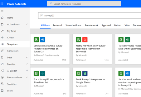

Why is QuickCapture not listed in Microsoft flow power automate? I see Survey123 listed.
Our IT dept has blocked other 3rd party webhooks and so cannot use integromat, I am able use survey123 forms and send email but not through QuickCapture
Please suggest how to send sms or email with photos in QuickCapture.
I appreciate your help.
Mandy_Li
Hi @SusanMathai , please see this post. Let us know if you have any other questions.
