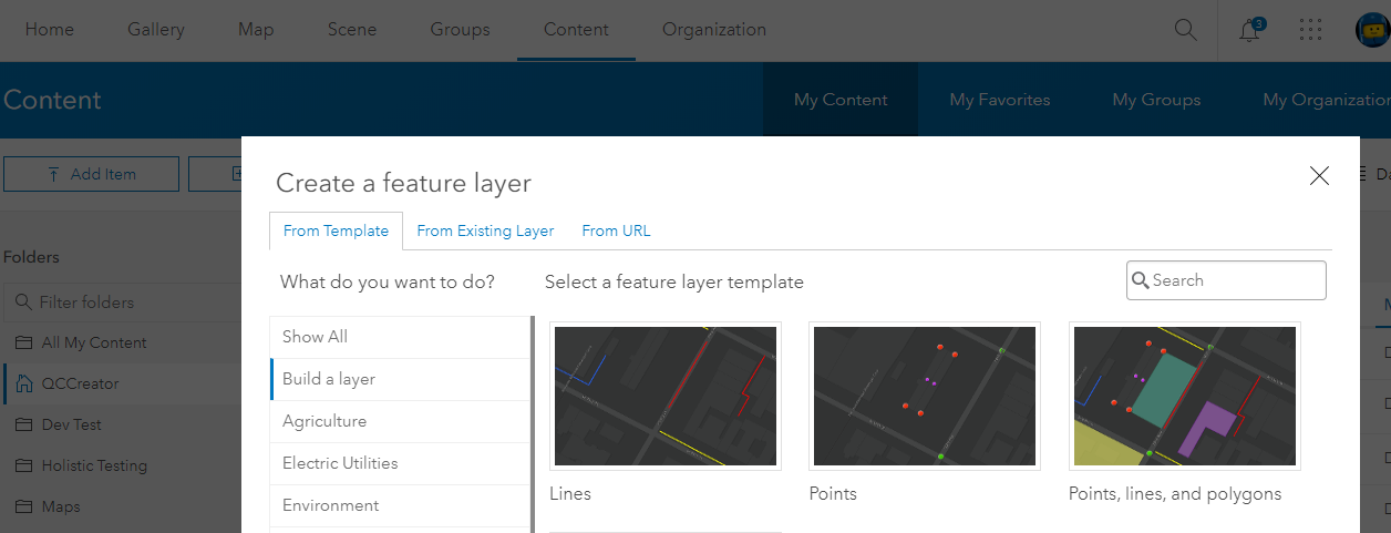

To create the template, sign into your organizational portal (with a Creator user type) and navigate through: Content=>Create=>Feature Layer. This will open the Create a feature layer dialog. From here you can choose Points, lines and polygons under Build a layer.
Click CREATE and configure the layer properties as you wish (i.e. Map extent, Title, Tags, Summary) and then click Done.

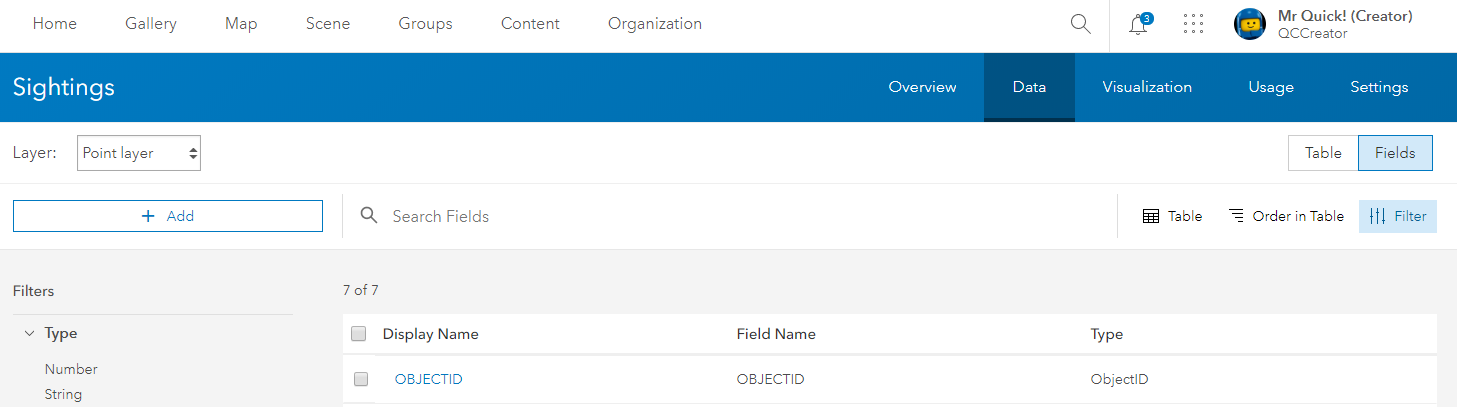

Next, you will need to create the fields you want to update when a new record is captured. This is done in the Data tab - click the Fields button.
Add the following fields to the Point layer:
- sighting (string)
- accuracy (double)
- capture_time (date)
- status (string)
- name (string)

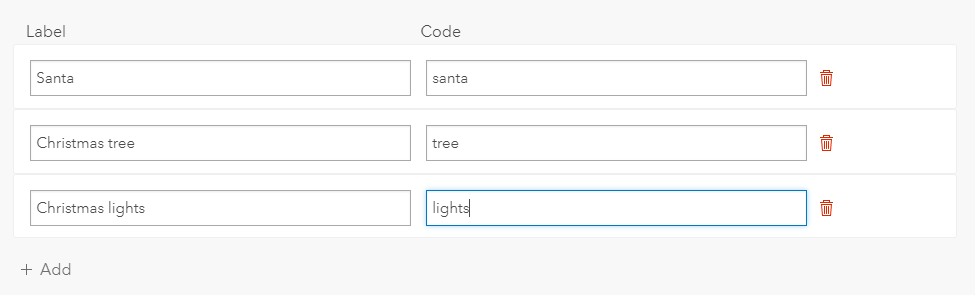

Additionally, for the sighting field, create a list with the following options:
