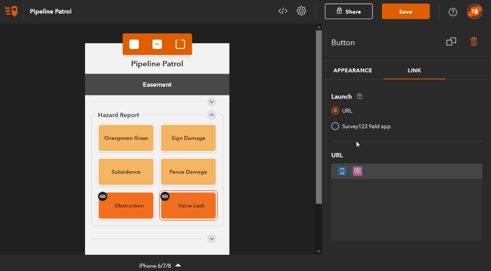

First and foremost, you’ll need to add a link button to your QuickCapture project. To do this, simply drag the link button and drop it to the project preview in Designer. You will also note there’s a link icon on the top left that indicates this is a link button.

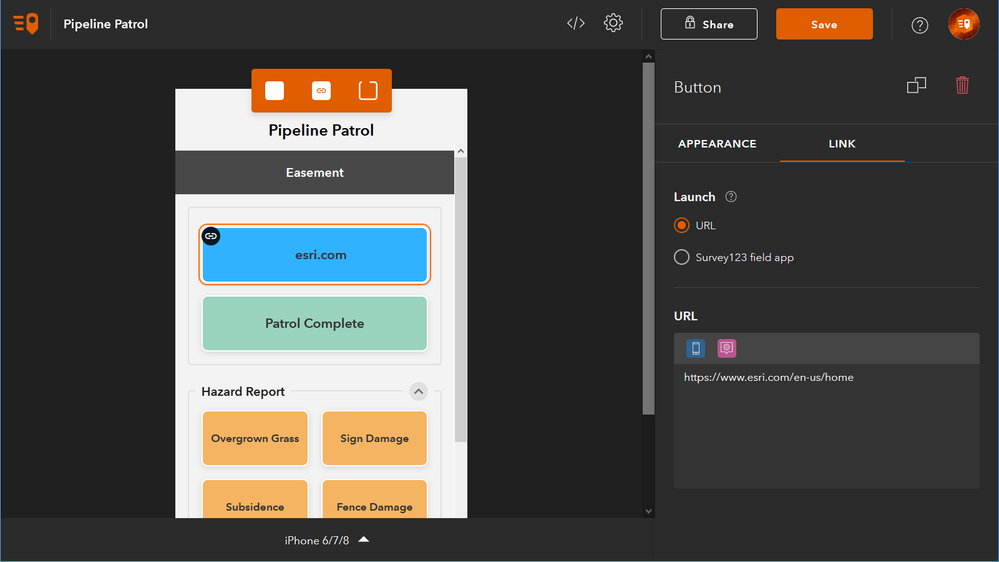

Configure link button to open a website/web app
The most basic idea is that you can use link button to launch any URL from QuickCapture, e.g., a website that provides support information for the end-users.
Moreover, you can include dynamic content into the target URL and pass captured information from QuickCapture to the URL. For example, with the URL parameters, you can define the scale level and center the web map with the captured location, or you can enhance the dashboard app by adding URL parameters and the trigger actions.
In this case, you need to manually construct the link button URL and predefine values for the URL parameters. QuickCapture supports using fixed values, device variables, or a project user input variable to add to the constructed URL. In the steps below, I will configure the link button to open a dashboard app, but also add a URL parameter to have the dashboard always center the map based on user’s captured location when the link button is pressed from QuickCapture.

You can use link buttons to launch Survey123 field app from QuickCapture. In QuickCapture designer, we made the configuration/integration experience as easy as possible. If you want to link to a survey from QuickCapture, you don’t have to manually construct the Survey123 link or custom URL, QuickCapture Designer will do it for you. In Designer, you can not only configure a link button to launch Survey123 field app directly and link to an existing survey, but also add survey questions and pass dynamic content to this selected survey. Again, you can match a fixed value, a device variable, or a project user input variable to the survey question, and the actual value for these variables will be captured and replaced by QuickCapture app through the link button. Optionally, you can pass captured location in QuickCapture as the input for the geopoint question in the survey, and configure the experience to return to QuickCapture after a survey is successfully submitted.
Let’s use the Pipeline Patrol project to demonstrate how to use QuickCapture and Survey123 together to record daily pipeline patrols and document identified hazards. In the project, patrols that encounter no issues are usually recorded with the tap of the Patrol Complete button; If any hazards are identified, they can be captured with additional buttons; For hazards that require detailed reporting, you can launch Survey123  from QuickCapture to collect more information through the smart form in Survey123:
  1. First, add the link button Valve Leak and set it to launch the Survey123 field app.
  2. Select a survey you want to link to.
  3. Select and add questions from the survey and pass predefined values to these questions. When configuring this, Designer is automatically constructing the Survey123 custom URL based on your selection made on the UI.
  4. Toggle on the options to pass location to Survey123 and return to QuickCapture after the survey submission.
