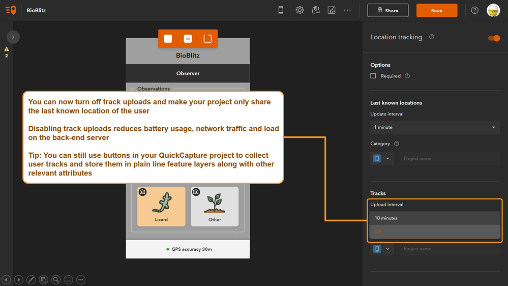

Collect the last known location only
Ordinarily, location tracking will allow you to monitor the last known location of users, as well as log where they have been. In some workflows, you just need to know where people are. With this update, you can now configure your QuickCapture project to collect just the last known location.
Why would you want to disable the collection of location tracks? As a general rule, you should not collect more information than you need. In many workflows collecting location tracks is of great value, but sometimes you just need to monitor last known locations.  By disabling location tracks you will reduce network bandwidth requirements and lower load on the back-end infrastructure.

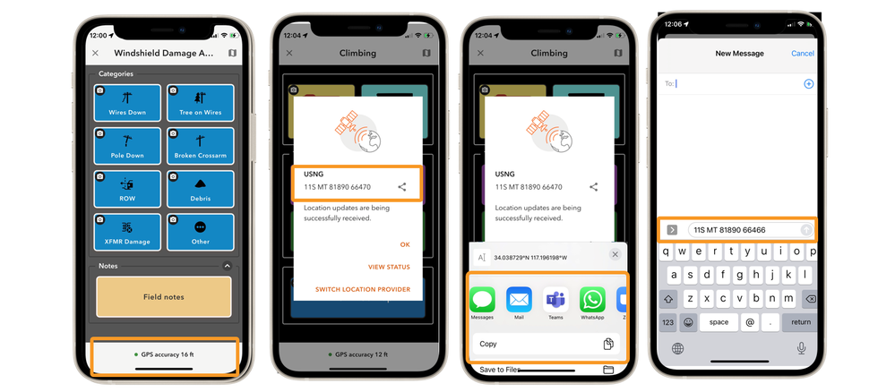

Of course you can always use location tracking to share with others where you are, but sometimes, you need to share your coordinates over the radio, or over a text message. This is of particular importance to emergency response teams, for example.
Starting with this release, as shown below, you can share your location coordinates with others by simply tapping on the bottom of the app.

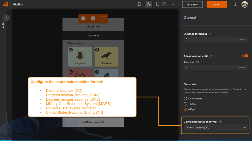

As the author of the QuickCapture project you can configure what coordinate notation should be used. You may want to choose USNG, or MGRS, decimal degrees, etc. All these options are available in QuickCapture designer. Simply go to the project settings dialog.
