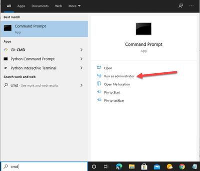

  8. In Windows Search, type in cmd and then select Command Prompt and Run as administrator.
