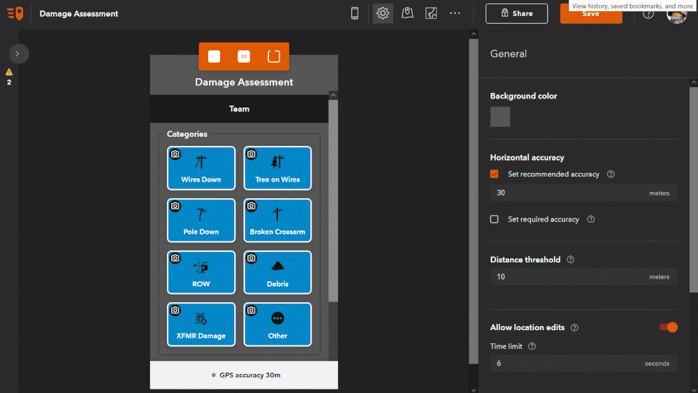

  • Login into QuickCapture designer and open your project in edit mode.
  • Now, get the itemId of your QuickCapture project from the browser address. In the screenshot below the itemId is highlighted in red.  Make sure you do not include the / slashes at the end and beginning.
