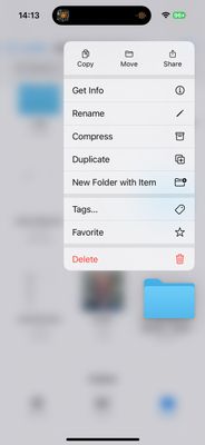

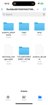

@ChrisChris  - I'd get the official word from Esri but I have been able to navigate to the "files" folder on iPhone using this workflow
https://support.apple.com/guide/iphone/find-files-and-folders-iphe4bff8827/ios - navigating to the Files app on iPhone > "On My iPhone" > QuickCapture > ArcGIS > ArcGIS QuickCapture > click on the unique item id folder for your project/user - then "long tap" on that folder > Share - then just email it to yourself or whoever can unpack the data.
