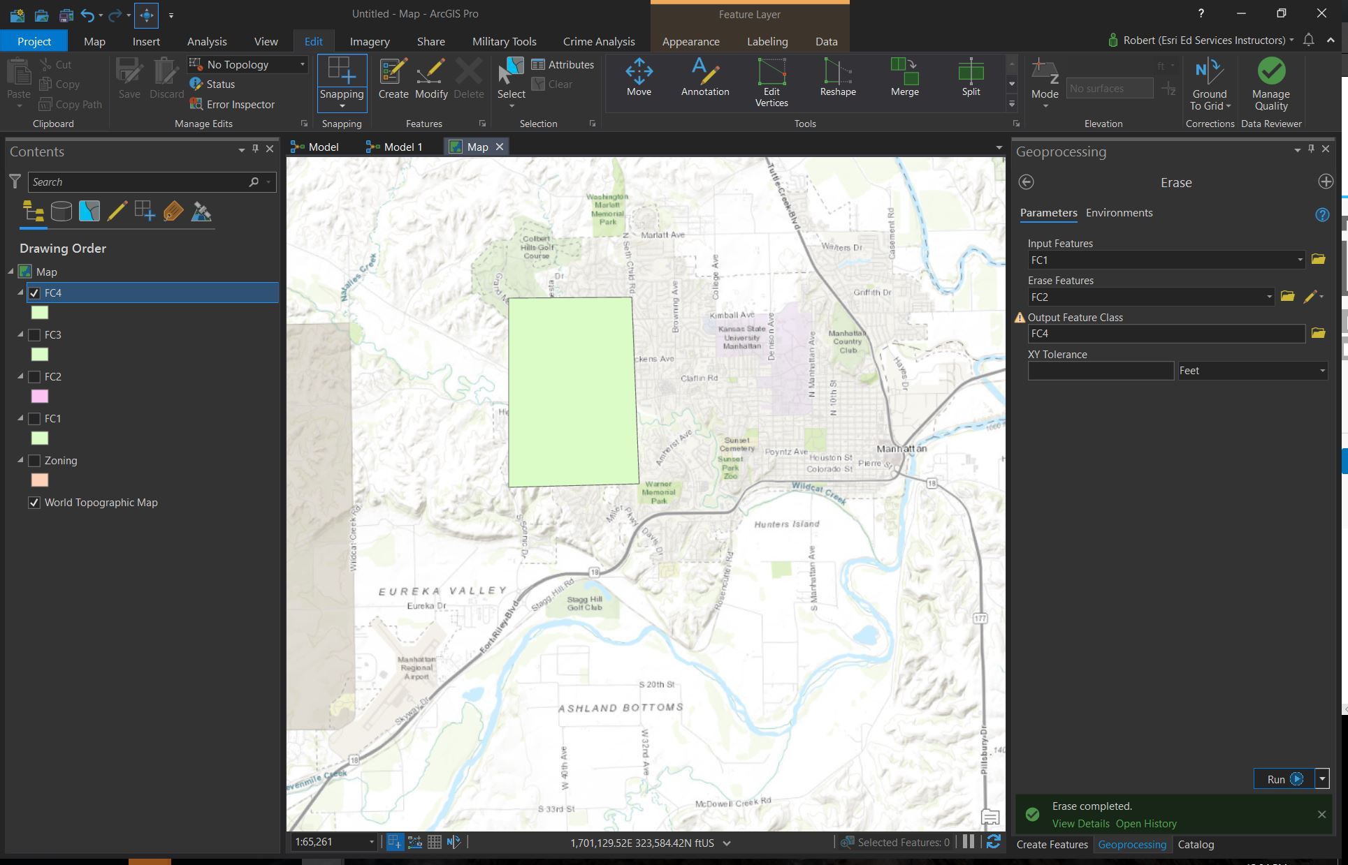

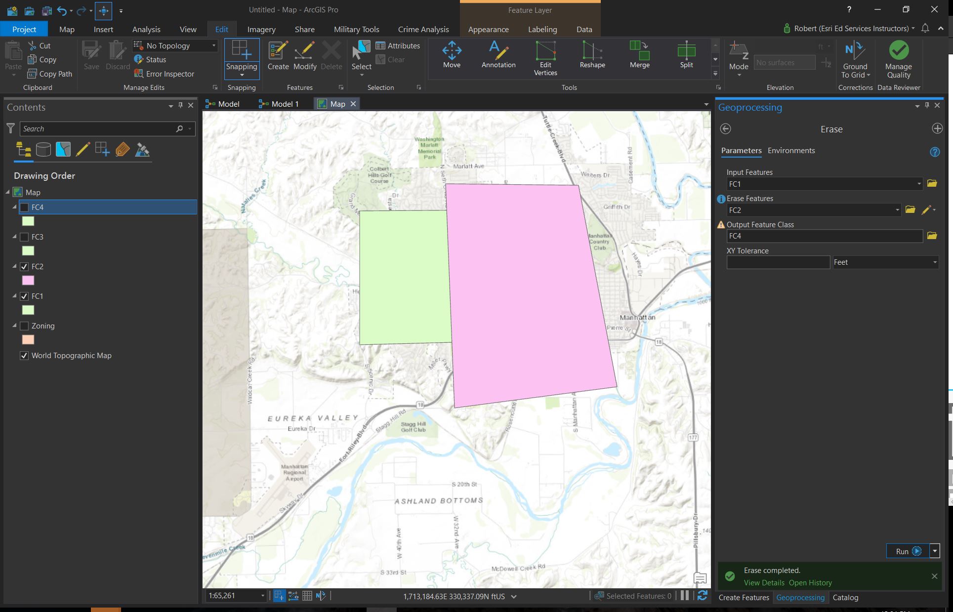

I have to separate polygon layers, layer 1 and layer 2. The polygons in layer 2 don't completely cover the polygons in layer 1, therefore, I'd like to create a layer 3 that are polygons that aren't overlapped. Also, I'm using ArcGIS Pro 2.4 if that matters.
Robert_LeClair
Esri Esteemed Contributor
I ran a quick Pro session to see the differences.  The first image is the 2 overlapping polygons.  The second image is the output from Symmetrical Difference.  The third image is the output from Erase.  Very different views.

I found the following that describes the differences:
  1. Erase - This tool creates a feature class from those features or portions of features outside the erase feature class.
  2. Symmetrical Difference - This tool creates a feature class from those features or portions of features that are not common to any of the other inputs.
