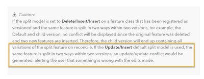

Doing some reading- I think this is what the error is that I am seeing:
This is a tad frustrating, but we can work around for now. Hopefully, once we upgrade, we can use the delete/insert/insert model and this won't be an issue anymore.
