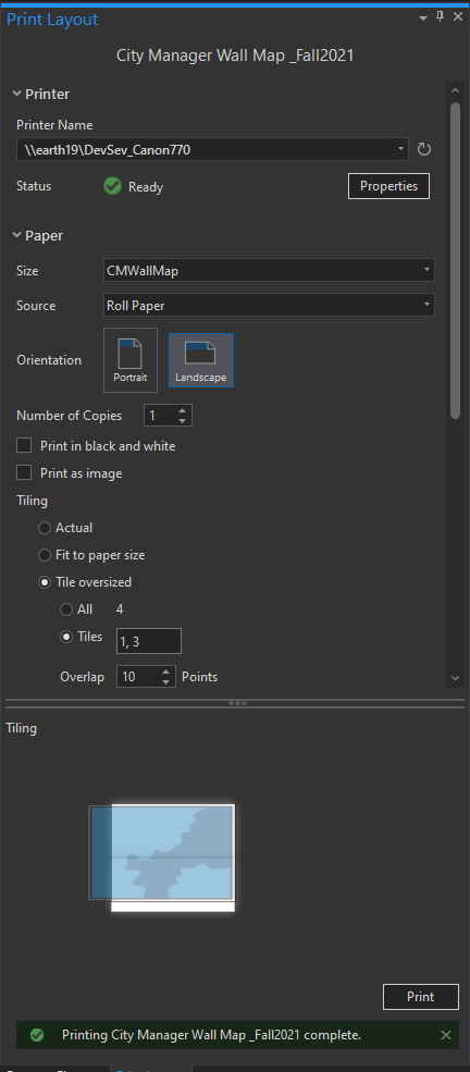

Hello,
I am printing 2 tiles that are 36x82" directly from ArcGIS Pro. Everything except the basemap printed.
I cannot export to PDF or Image and print. This makes the files too large and the printing process crashes, I have tried a number of settings and options for over a week with pdfs and images, so I'd like to focus on why pro isn't printing the basemap.
Any assistance would be very welcome!!
All labels and features printed. Just the World Terrain Base basemap didn't.
Thank you for your input!
Cheers!
Jessica

This issue looks to be related to the scale ranges set for the base map. We need to adjust the scale ranges so the scale to which we have the base map set to is included.
https://pro.arcgis.com/en/pro-app/latest/help/mapping/layer-properties/display-layers-at-certain-sca...

JessicaJThompson
@jcarlson David from ESRI helped me find a solution, which may help you the next time!
DavidLombardo
JessicaJThompson
Thank you so much for your assistance and finding this little obscure source. It worked! I was able to print with the basemap!
