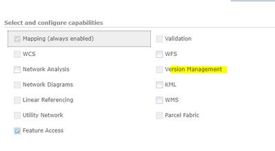

Im trying to share a feature service with branch versioning to AGS but cant enable the version management:
Does share branch versioning only with portal and enterprise and not AGS standalone?

The IMPORTANT PART. Pull up your ArcGIS Server Admin page and navigate to the service in question. The URL should be something like "https://MyServer/arcgis/admin/services/MyServiceName.MapServer/" Choose EDIT at the bottom of the page and then do a search for the word "versionmanagementserver" just a few lines below that you will see
"enabled": "false",
change this value to true.
After I made this change I was able to successfully edit and manage branched versions from the feature service inside ArcGIS Pro to a stand alone ArcGIS Server.

@Antonio_Dang , in order for the Version Management to be available you need to make sure you have the .SDE connection as Branched, the data which you are publishing also needs to be branch versioned and you need to be the owner of the database. This will allow you to publish branch versioned datasets.
In ArcGIS Pro you can select this service capability in the publishing process.

I have .sde connect as branched and also versioned. but i still dont get this option Version management.
