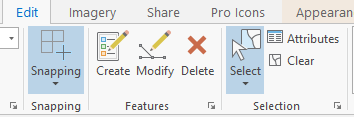

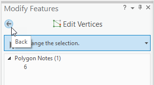

Hi @Anonymous User
With the core select tool activated (first screenshot below), you can right click on the map and access a context menu command that activates the Edit Vertices tool, which will then be hosted in the Modify Features pane.
For all modify tools, to deactivate them, you can either switch to any other tool (like the core select tool or another modify tool), or hit the back button on the modify pane to deactivate that tool and switch to the Explore tool.

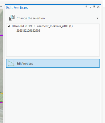

My Edit Vertices pane doesn't have a back button version 2.8.0? I guess I just close the pane? (Oh I see now. If you right click: this is the pane you get. But if you click modify features, then click edit vertices you get the pane you showed. ugh. software mistake there, I would think).
