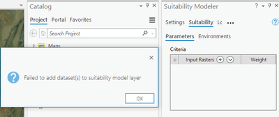

Hello, I am transitioning from ArcMap to ArcGIS Pro 2.7. I want to use the suitability modeler tool in ArcGIS Pro to identify locations best situated for green infrastructures. I have all of my layers processed to raster already. When I try to create a new suitability model and load the raster in the parameter section it shows error " Failed to add data set to suitability model layer ". I am not sure why it is giving me this error.

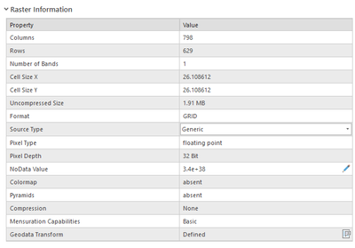

Type, location and coordinate system of the data?

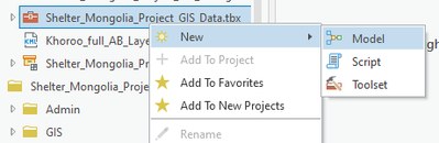

I did try using data that worked using the traditional Suitability Modeling approach (pic below). I actually followed the suitability modeling workflow lesson in ESRI with the bob cat case study. I was able to do it that way but not sure why it does not work with the dynamic suitability modeler tool.

Please can you post a screen shot and what type of data are you trying to add?
AsnikaBajracharya
Steve,
Here is the error message that is displayed regardless of what ever raster data I try to upload. In this particular case I tried to upload slope raster that I calculated using the DEM.
SteveLynch
what happens if you use the DEM

Trying to add DEM also gives the same issue.
