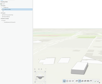

When I try to edit a multipatch feature with edit vertices, it disappears.  I can edit using scale fine, but edit vertices makes it disappear.  See screen capture MP4 attached for what I mean.  It isn't just hiding below the ground surface.  It seems to be gone.

After pulling my hair out and a lot of cussing while waiting for esri "customer service" (and I use that term, lightly) to call me back, I have discovered it has something to do with setting the elevation of the multipatch feature to "On the ground". I turned off the WorldElevation3D/Terrain3D elevation surface mid-edit and the selected feature is visible.
