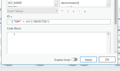

OIC your issue now, yeah, that is a line number automatically inserted by Pro, NOT part of the code.
With line numbers off, should look more like this (with nothing in the Code Block section):

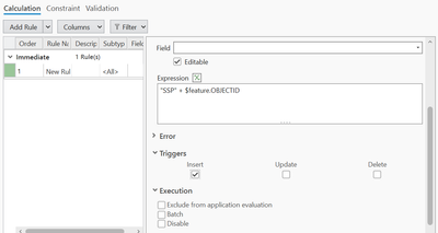

As for automatically populating the field moving forward I would suggest an attribute rule.  Something like this should do the trick. The Insert Trigger ensures that the field is only calculated when a new feature is created.

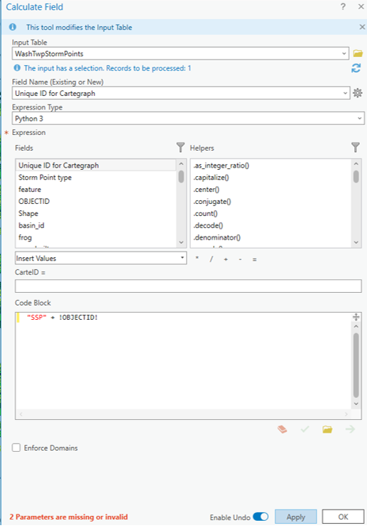

I am new to Python. How do I put this in the field calculator? What expression do I use? When I put
"SSP" + !OBJECTID!
in the Code Block I get an error: 2 parameters are missing or invalid.
Thanks!

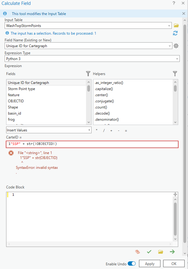

I am using Pro. I pasted the code and I get the error I mentioned above.Screenshot 2023-05-05 112359.png

AndrewAidt2

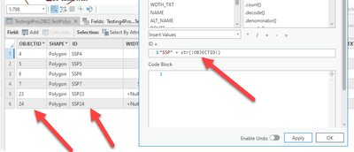

RhettZufelt
MVP Notable Contributor
Working fine in 2.9.3 and 3.1.1.

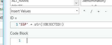

It appears as if it doesn't like the first double quote in your syntax for some reason (perhaps copy/pasted in windoze).  Try replacing or just use single quotes, they work as well.

What is the blue 1 you have at the beginning? I don't get that.
AndrewAidt2
Mine is black...
