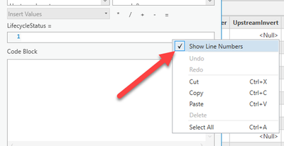

That is the line number.  Not sure why yours is black (or mine is blue), probably a windows setting.
you can turn that on/off with right click (in Code Block as well).
Did you get it to work?
R_
RhettZufelt
MVP Notable Contributor
OIC your issue now, yeah, that is a line number automatically inserted by Pro, NOT part of the code.
With line numbers off, should look more like this (with nothing in the Code Block section):
