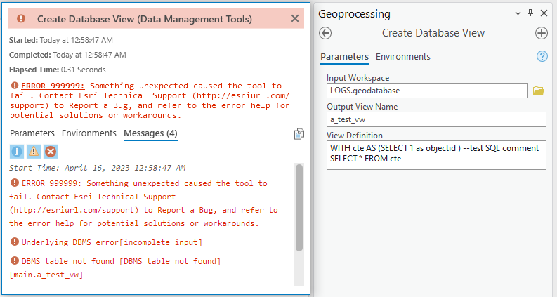

When creating a database view in a mobile geodatabase using the Create Database View geoprocessing tool:
The GP tool doesn't seem to allow SQL comments in the WITH clause (aka the CTE - Common Table Expression).
WITH cte AS (SELECT 1 as objectid ) --test SQL comment
SELECT * FROM cte
ERROR 999999: Something unexpected caused the tool to fail. Contact Esri Technical Support (http://esriurl.com/support) to Report a Bug, and refer to the error help for potential solutions or workarounds.
Underlying DBMS error[incomplete input]
DBMS table not found [DBMS table not found] [main.a_test_vw]
Whereas I can put comments elsewhere in the query, such as in the main SELECT:
SELECT * FROM cte --test SQL comment
Is that a known issue?
Note: I don't have this problem when creating the view in the mobile GDB using a SQL Client like DBeaver. I only have the problem when creating the view in ArcGIS Pro.
