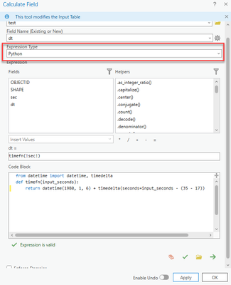

Okay, so all you have to do is pop open your Field Calculator, write a simple function, and apply to your target date field like so:
With your sample values, I get:

EarlMedina
