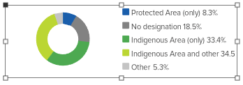

I am using Pro 3.1.2 and trying to insert a pie chart into my layout with a legend. When I noticed a legend label is truncated, I increase the element's width until it appears. pie chart layout 1.png
However, with this chart making it wider doesn't appear to fix it (nor would I want the chart that far from its legend!).
Is there a setting to help resolve this?

Hi @KelleeKoenig1 ,
This is likely due to a bug that has been fixed in the 3.2 release. If you are able to share your data/project (email: [email protected]), I'd be happy to take a look to ensure that it's been fixed in 3.2.

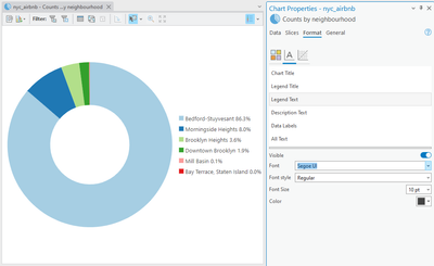

In the meantime, as a workaround I would suggest that you try adjusting the font properties to see if that allows you to see the full labels. This can be done in the Format tab of the Chart Properties pane:
