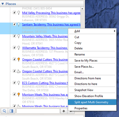

Hello,
So I have an old Google MyMaps that I'd like to convert to a nice new ArcGIS Online web map that can be embedded in place. Thankfully the MyMaps allows you to download the map as a KML or KMZ. When I look at the KML or KMZ in Google Earth I can see all of the points, but when I use the Geoprocessing to convert that to a layer it does not actually convert all the features. The layer has 11 features and the KML has over 30. Tried both the KML and KMZ.
Here is the mymaps: https://www.google.com/maps/d/viewer?mid=1o5Yv_4CvILqTJEnz65IkObeFPgBIH9A&femb=1&ll=44.0752723934698...
Any ideas?
AdrianWelsh
MVP Honored Contributor
Many of your features in that KML are in "multi geometries". In a program like Google Earth, you need to right click on one of the features and choose split apart multi geometry. Then your KML can come into ArcGIS Pro properly.
