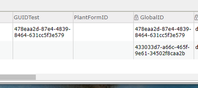

I am seeing that the Attribute Table and the Attributes pane show GlobalID differently. One is all upper case and one is lower.
I would call it a bug.
thanks

Since I am not getting anywhere I went to support.  They agree 123 and Field Maps is doing lowercase when everyone else is doing upper.  But they say it is not a bug but an enhancement.
ENH-000130624
One possible workaround I am testing is to make any ID field a GUID.  GUID does not seem to care about upper and lower so the relationships work.  It is harder to use a GUID and it forces me to add the {} and it cannot be a diff text key which is a bummer.
Also even when I paste in a upper GUID it changes it to lower in AGOL
But In ArcMap they are all upper and show as upper.
So AGOL, 123, and Field Maps is all lower or shows lower but ArcMap, Pro, SQL, etc it is all upper and shows upper.
For sure a inconsistency that is very confusing.  I hope all the teams can just agree on one choice and use it.

Just proved today that if you use the Attributes window to edit in Pro it will change the 123 parentGlobalID field to uppercase - and this does break the relationship!  Support said that would not break it but it for sure does.  I thought so also as did @JamesTedrick
If you use Field Calculator it will not change to upper case so use that.
FYI to all.
