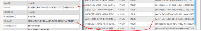

DougBrowning
MVP Esteemed Contributor
Actual video of it happening @James_Whitacre .  These came from 123, where some but not all forms store as lower.  I cannot even figure out which one is "correct".  I posted to 123 and they do not think it is an issue but it for sure is.  thanks  https://community.esri.com/t5/arcgis-survey123-questions/globalid-in-lowercase-from-collector-to-sur...

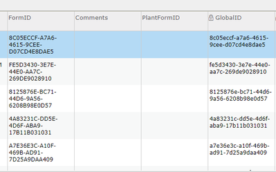

DougBrowning
Ok this one is getting me in the web map now.
It shows globalid as lower case in the attribute table but when I run a simple calc to put it into the FormID field it suddenly goes upper case!
Now the super fantastic part is relationship classes see the uppercase and lowercase as different so it breaks all the relates!
At this point how are we supposed to program around all of this?  I know this is not really Pro at this point but these kinds of inconsistencies is a killer.  I am still not sure which is correct?  What is the Esri standard?
