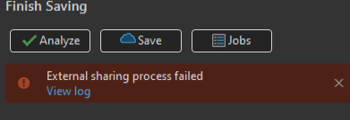

I'm trying to update a secure web map that i own on our Portal with more finessed symbology from ArcGIS Pro, but every time it fails. From the logs, the only error line item i see is this:
StatusMessage: Problems getting data connection for: CIMPATH=[long item id string].json
Any ideas?
