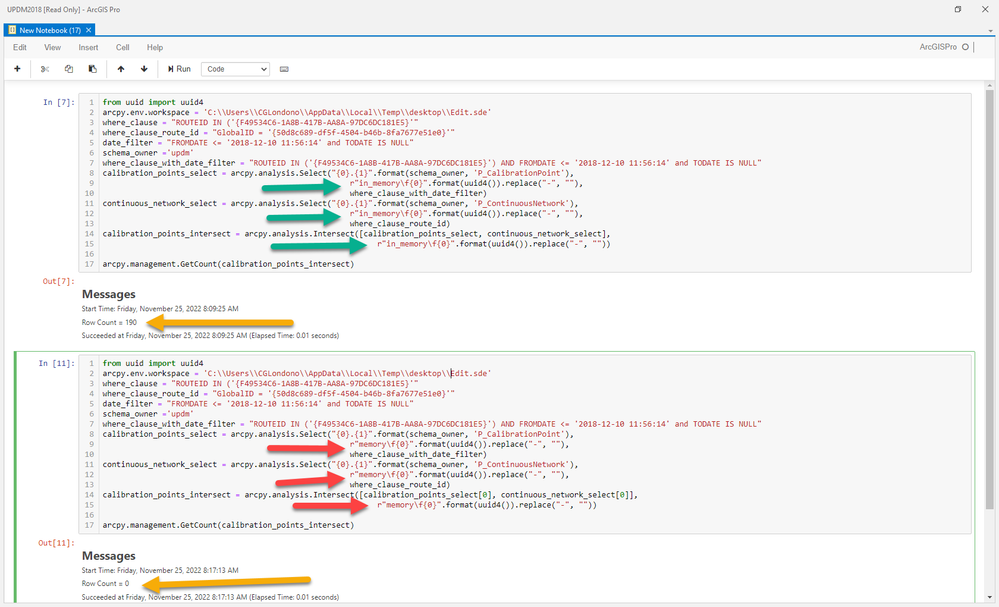

I am using ArcGIS Pro 2.9, and trying to make some basic spatial operations.
Two sets of features were selected from a geodatabase, and using them, an intersection will be performed.
As it is not intended to persist this objects, the script use the "in_memory" workspace (it was done for the version 2.1 thinking in ArcDesktop).
Today, in an attempt to update the script with the new characteristics of the version 2.9, I found that the intersect tool does not like the memory workspaces.
Here is my evidence:
reading the documentation of the intersect tool, it does not mention a restriction for this kind of datasets.
Is this a bug? How do I report it?

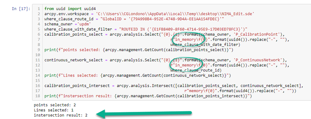

As I posted as evidence, both scenarios are the same, the only difference is the location of the expected result. but in order to provide more evidence, i ran the scripts against an smaller dataset, and print the results:

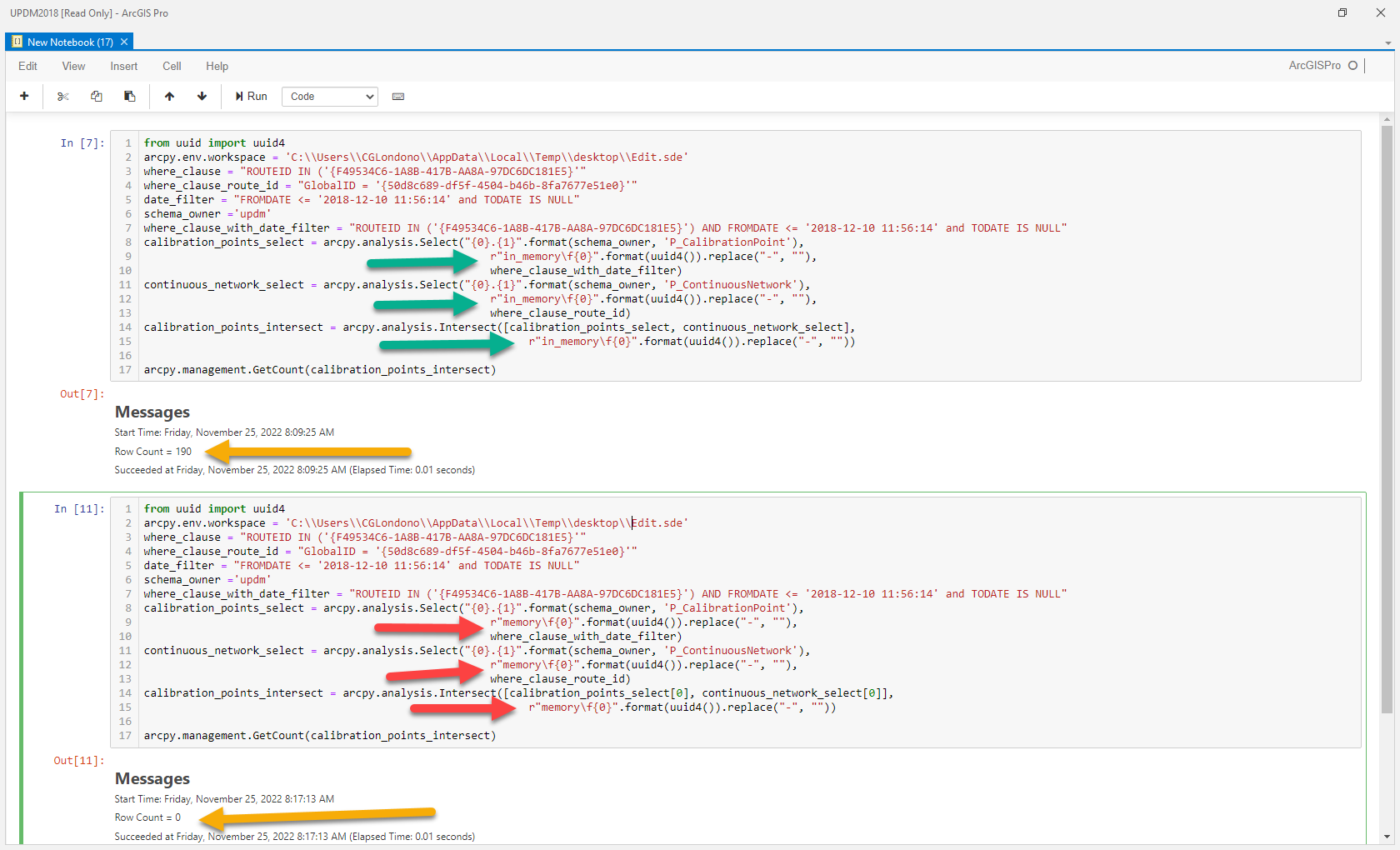

After some trial and error (not you pity documentation) I found that Intersect tool does not like "memory" (modern, state of the art) workspaces as INPUT, it does not care about the output:
Cristian_Galindo
Additional Note:
The tool MakeRouteEventLayer does not like either the "memory" workspaces as input.
The documentation: https://pro.arcgis.com/en/pro-app/2.9/tool-reference/linear-referencing/make-route-event-layer.htm
does not state this.
