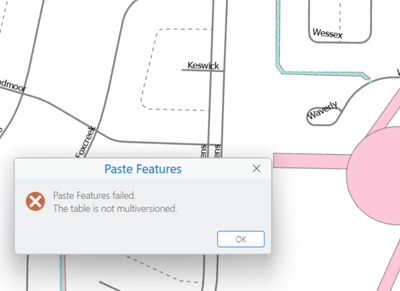

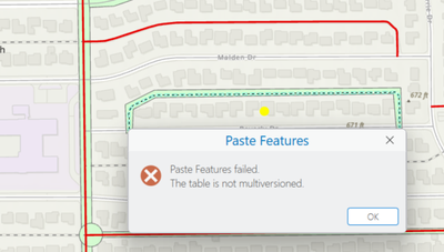

We have a recently UN-versioned dataset that is throwing this error. No feature classes are versioned within this dataset any longer. The errors are:
I wonder if there's something hung and we need to run that "Unregister As Versioned" tool just to be 100% sure.
