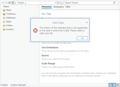

        I have created a style file (*.stylx) in ArcGIS Pro 3.0 and would like to distribute it to users who are using lower version of ArcGIS Pro(like 2.8, 2.9). An error occured("The version of the selected style is not supported or is otherwise invalid. Please select a valid .stylx file.") when they trying to add the style file into their ArcGIS Pro project , was wondering if there is any solution that can share the stylx file from higher version of ArcGIS Pro to lower version of ArcGIS Pro?

      @Robert_LeClair Thanks for the suggustion, unfortunately, I have already tried packing the whole project as a PPKX file and opened it in ArcGIS Pro 2.8. still no luck(same error message).
