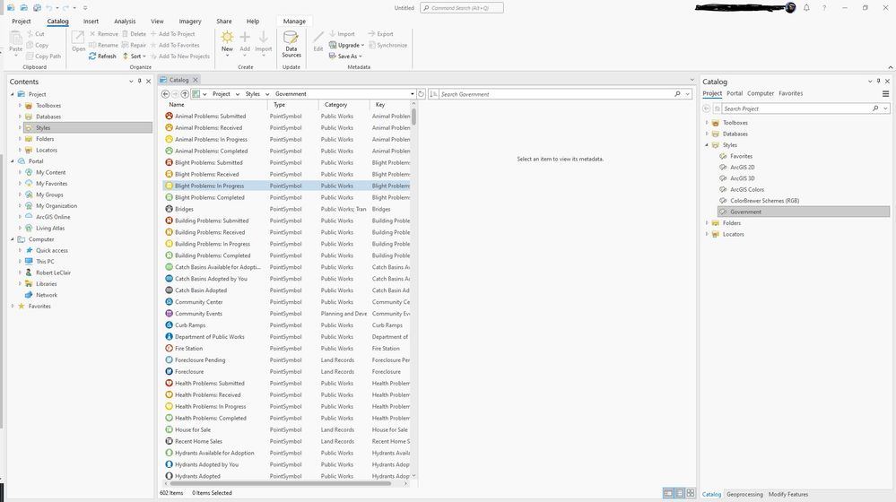

Hi Tamara - I'm using ArcGIS Pro 3.1.2 and the *.stylx worked just fine for me.  In the Catalog Pane, I right-clicked on the Styles folder and selected Add->Add Style.  Then navigated to the folder that had the stylx file and clicked OK.  In the screen grab, you can see that it's added and ready for use.  There is no ArcGIS Pro 3.8.8 - are you using ArcGIS 2.8.8 perhaps?  Can you upgrade to ArcGIS Pro 3.1.x?

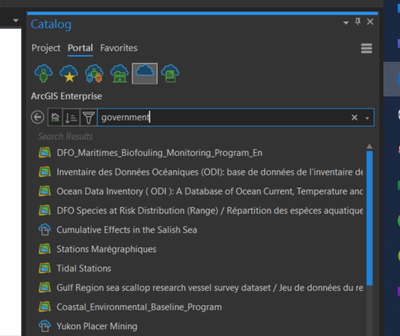

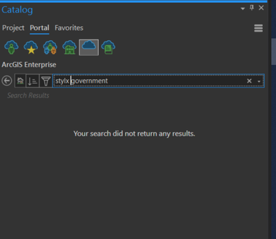

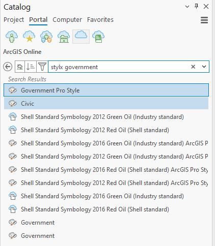

No worries - thought likely it was a typo.  So another thing to try is go to the Catalog Pane, and at the top, click the term Portal.  Then below Portal, click the solo cloud icon.  In the search box below that, type stylx government like I have in the screen grab below.  Right click on Government Pro Style and select Add Style.  Does that work?
TamaraBrown
I tried that as well, but the portal is linked to our own organization's portal which doesn't have any .stylx files.

I see.  You can go to the Project tab (top left) and select Portals on the left.  Then make your ArcGIS Online portal the active portal - you may have to sign in.  Then go through the search workflow I described, download and install the style file.  Once installed, go back to the Projects tab and make your organizations portal the active portal.  This should work for you.
