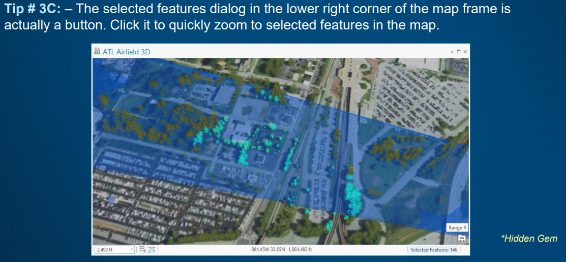

I recently saw a Twitter post (a tweet?) with this ArcGIS Pro tip: Nathan Shephard on Twitter: "Random @ArcGISPro tip - you can click the 'Selected Features' count lab...
And I thought to myself, "Well, we see these scattered about all over - wouldn't it be cool to find these in one place?"  Wait, somebody must have already done this, right?  So I did what I do with so many questions and I Googled it.  You can do the same, but I figured I'd help by getting you started: Click here to Google "arcgis pro tips and tricks"
Indeed, we do in fact get a number of results.  Like this one by James Sullivan‌ is golden: http://proceedings.esri.com/library/userconf/fed17/papers/fed_10.pdf I love how he calls out "hidden gems" and we see some convergence here with Nathan Shephard‌'s tip from his Twitter post.
