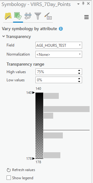

I'm trying to vary the transparency of a layer by an attribute field. The values in my field range from 5-179 (the values represent the age of a data point, in hours). However, when I specify the field, it only seems to detect values between 140-178.
The field type was originally a Double, but I have since converted the values to Short in order to simplify them. That didn't seem to make a difference. Is there some kind of limitation at play here that I'm not aware of? I am running ArcGIS Pro v2.7.3.

Looks like it has a limitation of upto 10,000 records. So, it took the values of first 10,000 records sorted by ObjectID. I couldn't find any documentation on this limitation.

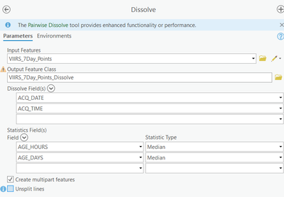

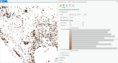

For a test, I dissolved the Feature Class based on "ACQ_DATE" and "ACQ_TIME", assuming the "AGE_HOURS" and "AGE_DAYS" are same for this combination (*but you will lose other attributes which differ within this combination, e.g. "BRIGHT_TI4", "FRP", etc.). The result is only 319 multipoint features.
Then, values for varying the symbology looks fine.
